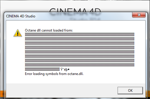

Hey there... I tried installing the Octane Renderer 0.72B plugin for cinema 4d, and I got the following error:
Any Ideas how can I fix it?
Octane Plugin version : 0.72B
Cinema4D Version: R14 Studio (Student Edition)

Sorry, i hope to be too late.
It's casual problem with a few other plugin. They are blocking the octane.dll.
You must manually copy files in libs32/libs64 folder to c4d root.
