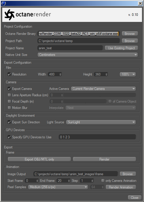

To your second question: Yes, there is a plugin available for CINEMA 4D:
To your first question: Unfortunately this is not possible. At least not yet. The current render plugin allows you to render animations on one Octane license only. I really haven't thought about distributing the rendering of animations similar to NET Render. -> I have to think about a bit more first.

At the moment the connection CINEMA 4D -> Octane is quite limited. The exporter tries to export C4D materials as good as possible, but OBJ/MTL is a major bottleneck and there is not much we can communicate to Octane via OBJ/MTL. After exporting, you usually have to setup/tweak lights and materials in Octane. On the other hand, the Octane materials are becoming more and more powerful now, so I guess there will be a solution in the future for this problem.
Anyway, for now the workflow is: Is export to OBJ/MTL (via the exporter), launch Octane, tweak/setup lights and materials and save the scene. After that you can change the geometry and the next export will relink the already existing Octane scene file (with all the nice materials and lights) with the new OBJ/MTL file, i.e. the materials of the Octane scene file override the materials of the MTL file.

During the export the scene geometry is exported as it would be used by the C4D internal renderer, i.e. all deformer objects, all generator objects, object render visibility and layer render visibility are evaluated. All render effects like displacement, shaders, post-effects and so on are not exported. It's not possible at the moment. So, yes you can animate your geometry as you want and the exporter takes care of it. The exporter also splits up multi-material objects and converts non-UV texture mappings to UV texture mappings. The resulting texture mapping is similar to the UV texture mapping in the viewport. Explicit vertex normals of normal tags or split edges are also exported correctly. On the Octane side of things, there basically arrives a big polygon soup with each polygon having one material assigned. So all objects, groups, hierarchies and other things get lost, as they are not needed anyway.
During an animation export, the plugin exports one frame, launches Octane, waits until Octane finishes rendering and closes itself, then exports the next frame and so on. Actually the export of the next frame is already started 5 seconds after Octane has been launched. If there exists already an Octane scene file with the same name and directory as the OBJ/MTL file combo, Octane will relink the materials of the scene file with the OBJ/MTL file.
I hope that answers your first question. To your second question: DOF can be set up in C4D and exported, or you set it up in Octane. Motion blur is exported only as camera motion blur and at the moment you can't adjust the strength of it (for now the shutter is open 50% of a frame interval). Object motion blur is not supported. Mantra did some animations with a motion vector pass, rendered in C4D to full geometric motion blur. I don't know good or bad it works and how good or bad it works together with DOF. He can probably say more about this.
