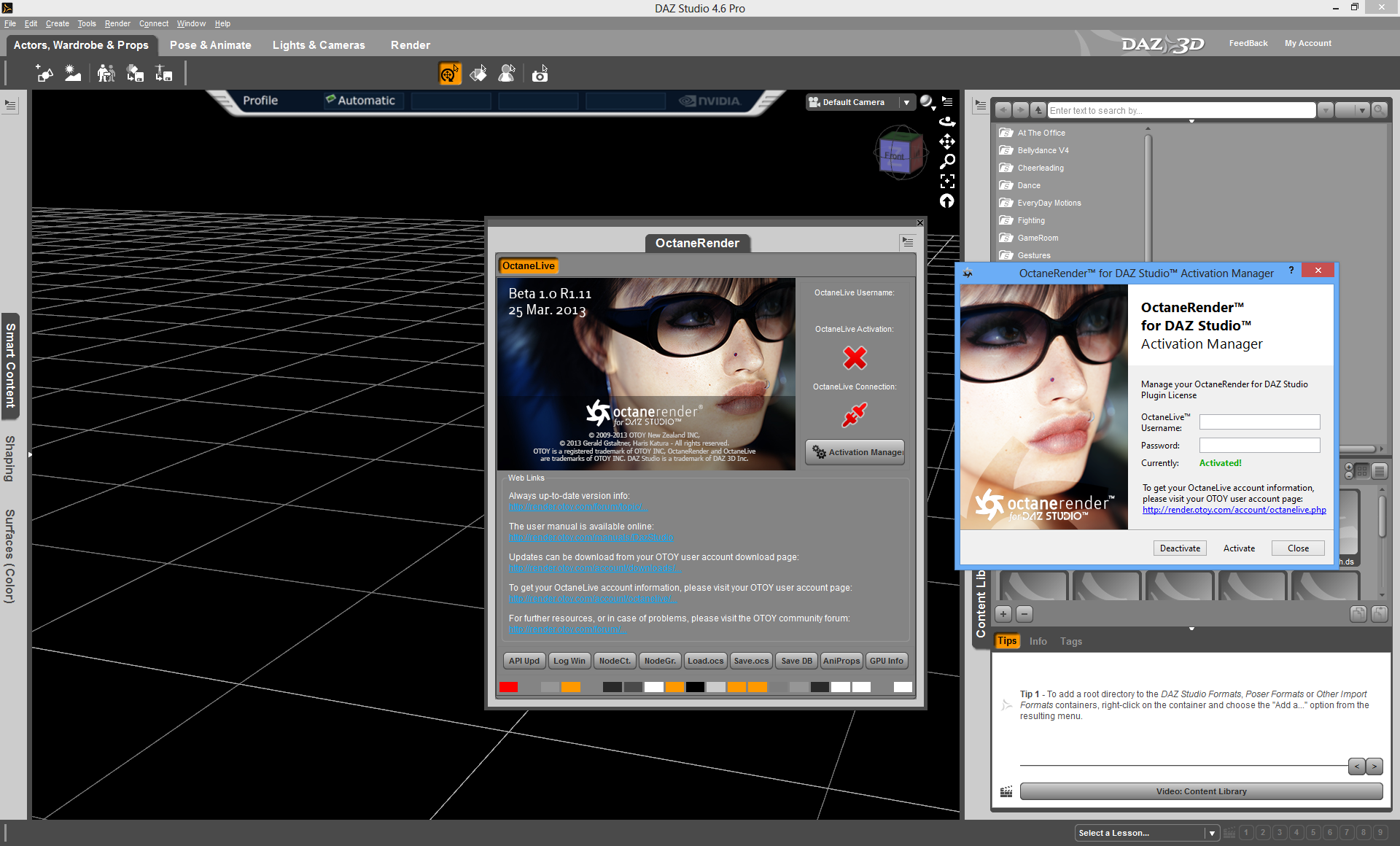

tried and tried but I dont understand... the confusion is tiring when trying work on a deadline..
Please Help With Activation Glitch
Moderator: BK
this happens, if the settings file is missing.
2 options:
- look if you find the OctaneRender_settings.oczdb file from a previous install
... the correct place is: %appdata%\DAZ 3D (you can paste this directly into the win explorer address bar)
... it's size should be >100kb or even several hundred kb (depending on use).
- if you just see one with around 10kb size, and can't find any recent one, please drop me a note, and i'll send you a pm with a default settings file, which allows you to re-enter your activation data...

glad to got you working!wlebrun wrote:Got it.. that was fast thanks..
