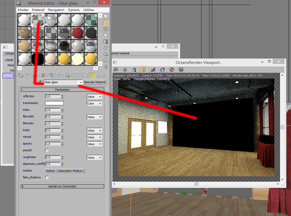

i use the Live DB Material of glass but i found that the surface will become all black. does any one have some suggestion to create a clear glass without using the Live DB? Thanks!

a simple glass material is fairly simple. Create a specular material and change index to 1.53, also set fake shadows on. This will allow sunlight to pass through glass. That's it.
check your specular depth, depending on you kernel
