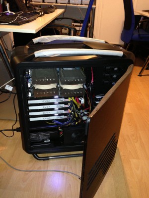

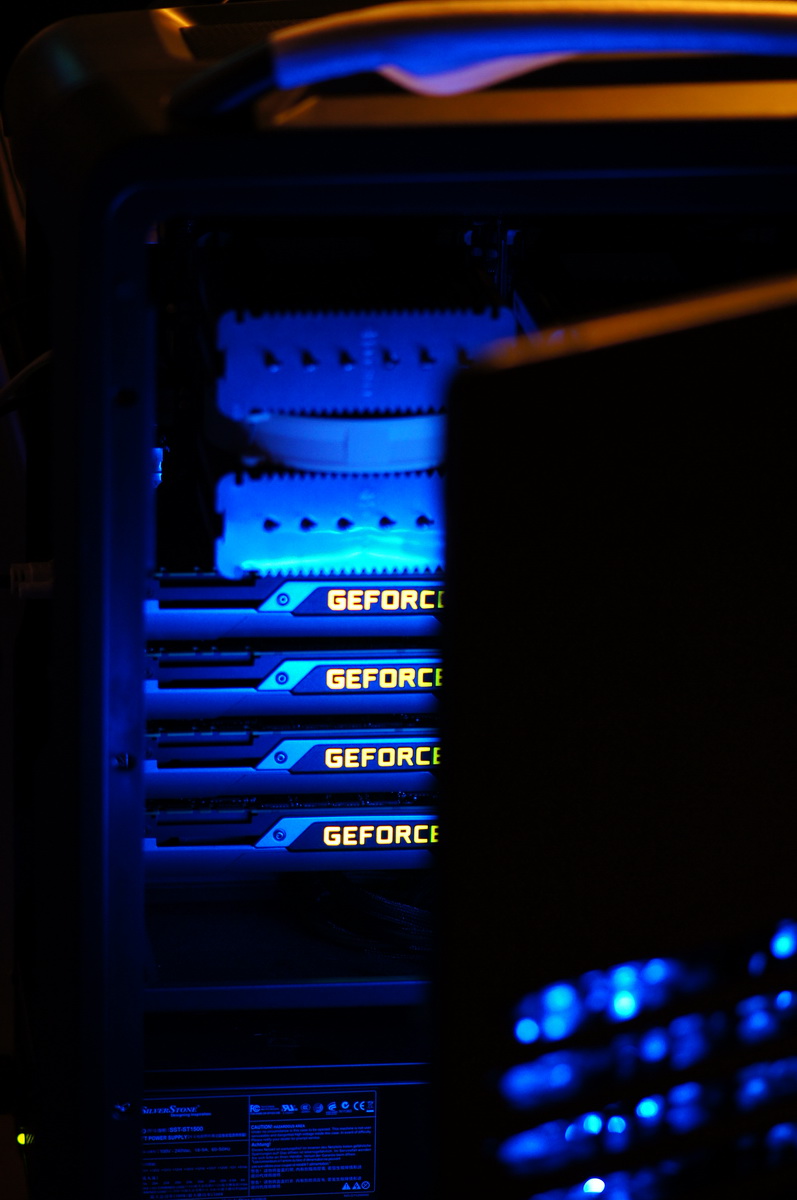

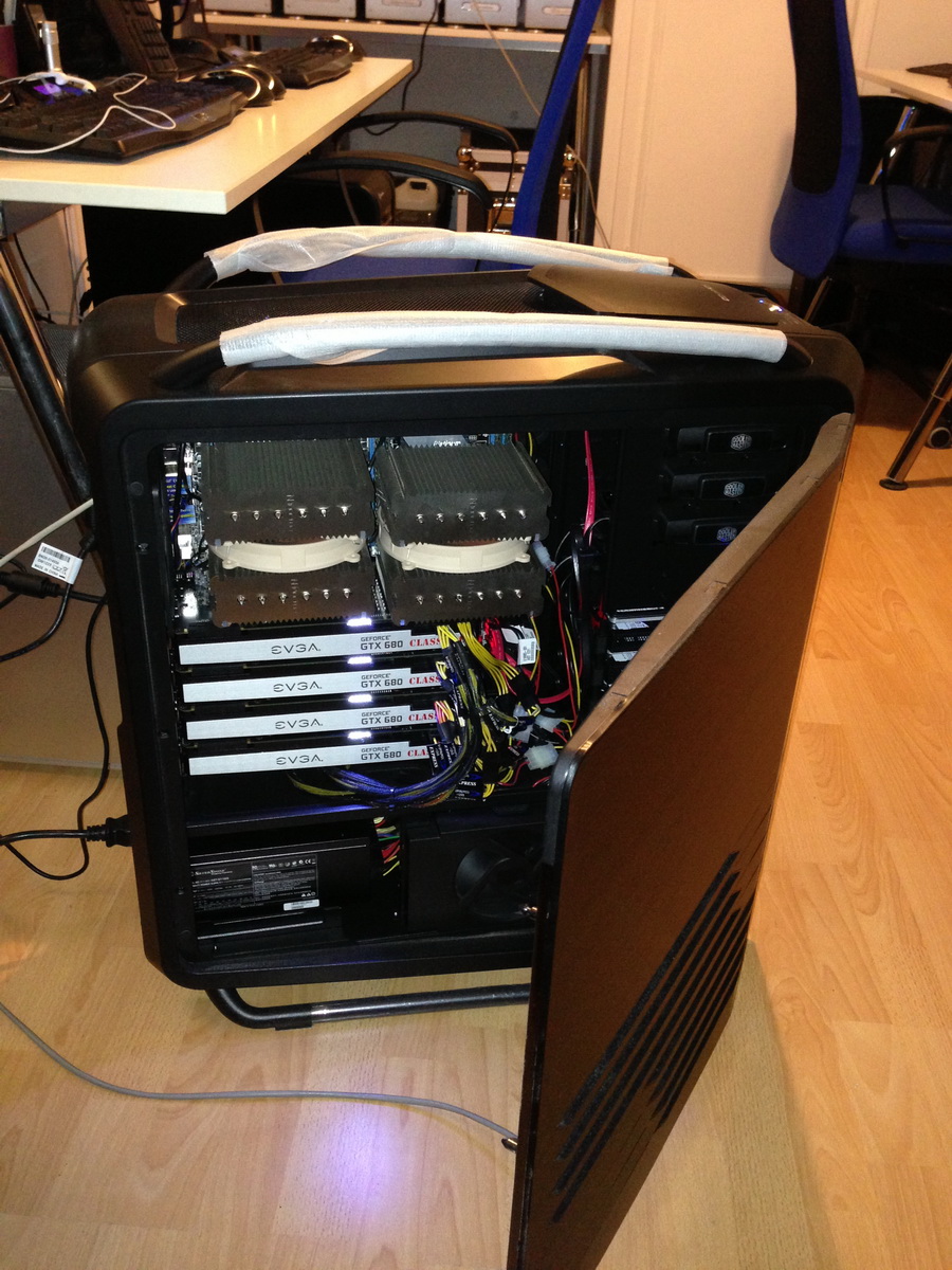

go with my setup
dual xeons 4 Titans (the picture show 4 GTX680 but 2 weeks later I upgraded the rig with 4 Titans)
the case is fantastic
you can fit how many ssd disks as you want
the default air cooling is not good as the TJ11 (gpu vertical position is better) but you can add more fans
