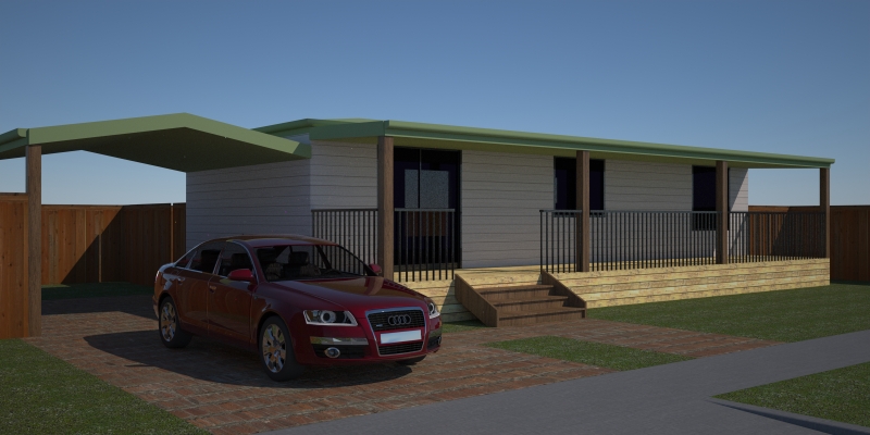

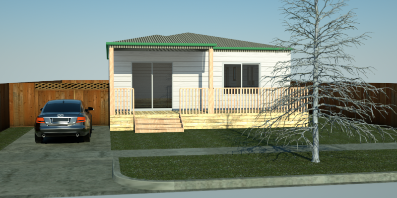

Thank you timbarnes and kubo for your advise. Unfortunately timeframe meant I had to revert to Maxwell to complete task. sample file attached. I will post Octane file once I become familiar with the software
