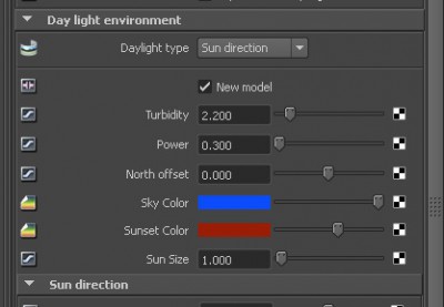

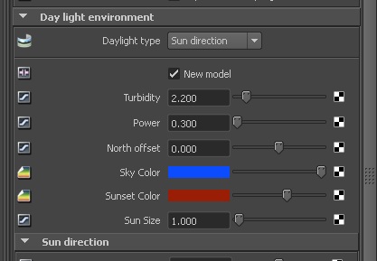

Hey jimstar just a heads up.
The Daylight Environment comes in with almost black sky and a greyish ground as default.

kayze wrote:Hey jimstar just a heads up.
It seems like some ancient Maya's version issues - as I see you still use 2011?..
Just have checked it in 2013 - all is OK...
