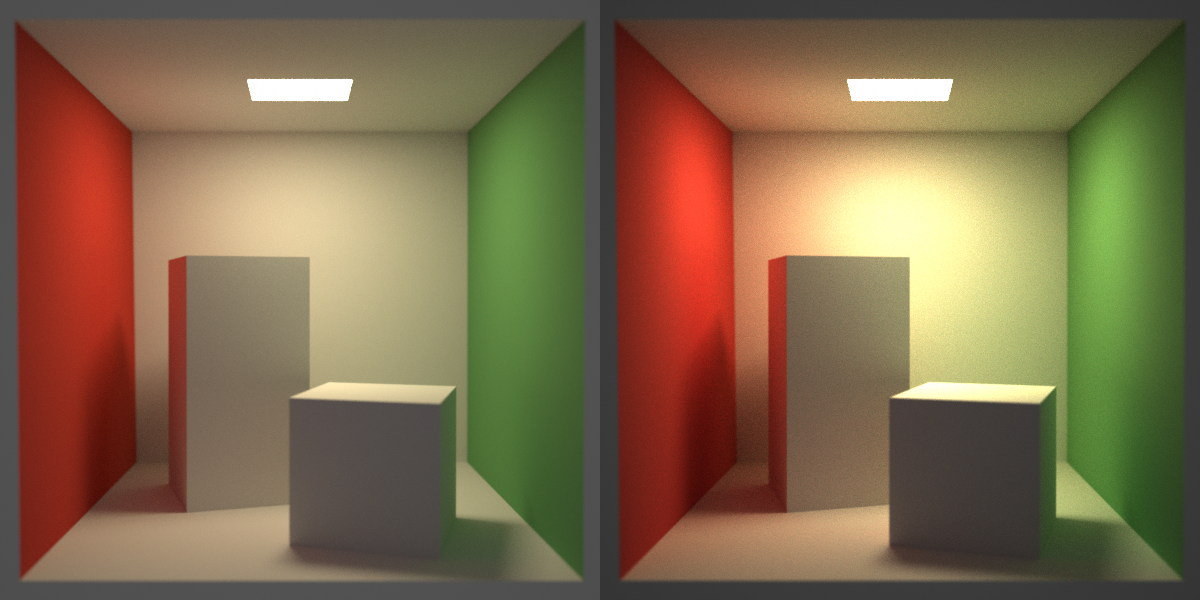

Here is an example using Octane: the left image was rendered using proper linear workflow, the right image was rendered assuming any RGB colors can be fed directly into the renderer, and the rendered colors can be directly sent to the screen. Note how harsh the lighting looks on the right.

The key issue is that a display doesn't normally have a linear response. (100, 100, 100) is not twice as bright as (50, 50, 50), in fact it is usually more than four times as bright. And images and RGB colors are usually given as values to be sent to the display.
The good news is that most settings in Octane are by default correctly set up. The most problematic part is inputting RGB values. The tone mapper by default is set up with gamma = 1.0 but the selected film curve does some gamma correction.

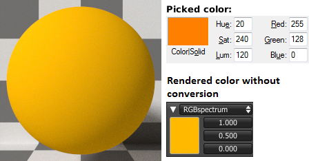

This image shows you the difference between (1.0, 0.5, 0.0) in linear space, and (255, 128, 0) in most color pickers (Photoshop, MS Paint, or #ff8000 on a web page):

  • RGB colors: If you have 8-bit colors given these are usually in sRGB, they need to be converted to linear space for Octane.
    • Versions prior to 1.17: If you get a hex value (like ff0807) you can paste it into the hex input at the bottom. Otherwise you may have to convert it to [0-1] range and use the sliders just above the hex input. In preferences » Application make sure the color picker space is set to sRGB. The sliders in the node inspector are linear, only use those if you know the RGB values are in linear space.
    • In version 1.17 and newer you can paste either the hex value (ff0807) or the decimal numbers (255 8 7) into the HEX field. These will then be converted to linear space, independent of the color picker space preference.
  • If you use an integrated plugin it may let you pick a color in screen space, and then feed these RGB values directly into octane. This will give a wrong (lighter and less saturated) color in the renderer. You may be able to enable linear workflow in the application to correct this problem.

So, what happened in our render above?
The most visible effect is that the falloff of the lighting is wrong. If you move away from a light source, the irradiance from this light source decreases with the square of the distance to the light source. If the distance from the light source doubles, the irradiance decreases by a factor 4.
Now our image is displayed on the screen, which usually applies a gamma curve with an exponent of 2.2. Suppose two points in the image have (80, 80, 80) and (20, 20, 20) as color values, a factor of four difference. Due to gamma correction this is displayed as 0.37% and 7.81% brightness. Our factor four difference according to the renderer turned into a difference of a factor 21 on the screen!
Another thing that you may note is that the green and red tints are approximately right. Here the error of feeding RGB values directly into the renderer is canceled out by the error of not correcting the rendered image before displaying it.
