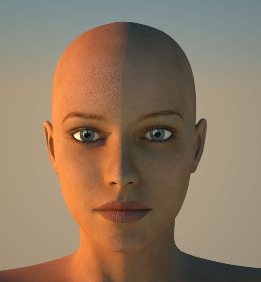

Hi there Paul, when I load a Default V4, I see that the bump in the Diffuse channel needs to be inverted to enable pores on the skin to display correctly, noticeable on the lips as well, Im getting the hang of the modifying my OctaneDefaults.py to get all my settings the way I want them, where can I change this issue?
RedSpec TGX for Poser / OctaneRender - OUT NOW visit http://redspec-sss.com/
Witpapier
Posts: 366
Joined: Sat Nov 24, 2012 2:13 pm
The same goes for the Glossy specular bumps
This is when manually inverted
This is the default bump direction

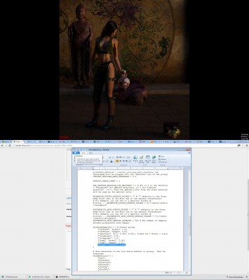

I figured it out!! :) added this line.. see pic below.
