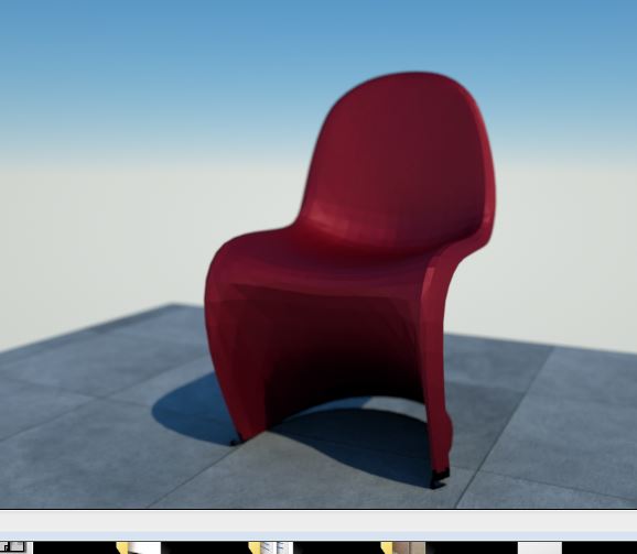

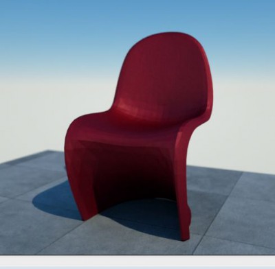

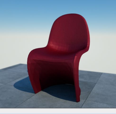

Hi, after testing some scenes I found that for interiors I need to decrease the rayepsilon value. I found that with 0,01 it works well. For exterior the standar value works well...
In the panton verner chair you can view the artifact in the bottom, and with rayepsilon 0.01 the artifact dissapear.

Thank you. My findings match that.

The manual has been updated with these settings - http://render.otoy.com/manuals/ArchiCAD/?page_id=294.
