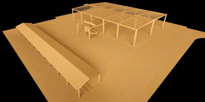

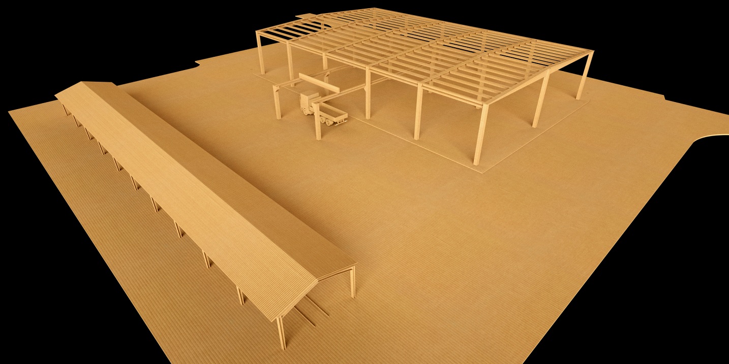

I love these kind of renders because they render FAST + they have great power of presentation. It simply makes you smile when you see dirty industry building rendered in cardboard material :)
+1 for this one
quick render
quick render
ArchiCad, Blender, Moi3d
GTX 580 3GB
Win 7, 64 Bit
