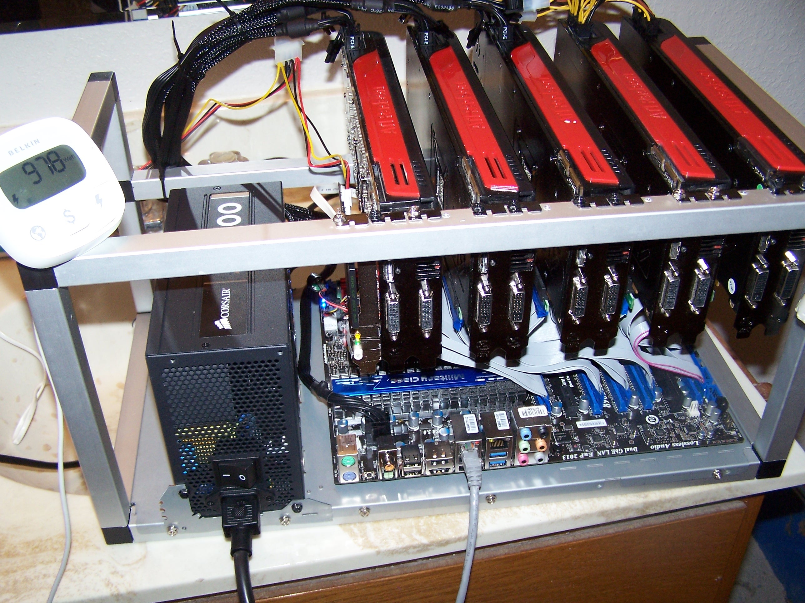

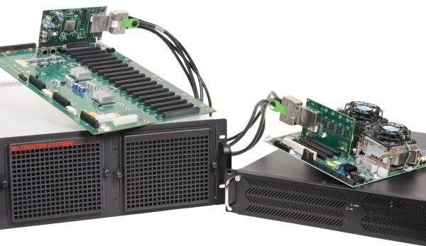

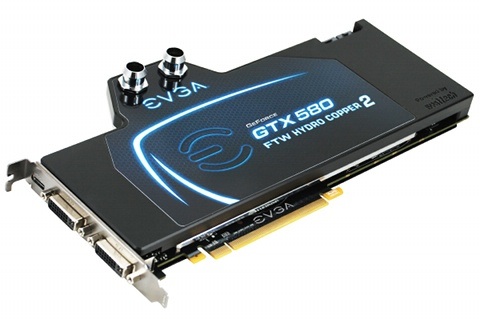

firstly, You'll not fit 7x Titans on any regular /ATX, EATX, etc..motherboard - for such use there are only special servers like those from tyan or treton systems /& others/ with something like up to 20 slot pci bacplate designs that You can use with hostboard or expansion kit
/unless You're willing to hardmod Your Titans /cuting some conectors and equiping them with waterblocks..- Your dream of fiting seven or eight dual slot cards in regular motherboard will face-slap-the-wall, 'cos mayority of high end boards have single slot spacing if the count of pcie is more then four & last true single slot GTX card out of the box /that is usable for octane/ was 580 HC from EVGA.
You'd probably have to use backpate and host card/or expander/ option,
to conecting rest of Your cards not on the motherboard itsef.
though if You go for flexible conectors /I might be wrong/ but
You'll not find a case that wouldn't need any moding to stuff Your cards.. & most sensible soluions would be to make smthn' like this:
..with all this in mind, if You're not goig to take specialised server, then no mater what route You're going to chose..the best option I see is - case labs http://caselabs-store.com/ there are a lot models, that would help You to fit crazy systems, with multiple PSUs or even multiple motherboards/ or expansion backplates if You wish -though You migh need some modding/ & then even if You want You can easilly find enough place for radiators if watercooling becomes interesting /since introduction of Titans, personally I don't see a reason - involved cost doesn't give back so much benefit & actually hurts the value, unless noise is an issue =)
