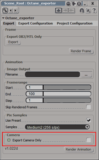

Export camera only for animations.

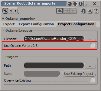

A switch to support Octane pre 2.3.

[attachment=2]camera_only.gif[/attachment]
[attachment=1]pre23.gif[/attachment]
