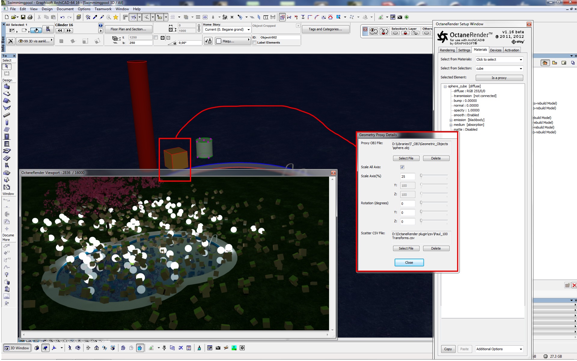

A couple of transform files you can try....
100 transforms is just displacement transformations - no rotation or scaling
1000 transforms has some scale and rotation variation in addition to the displacement randomness
Paul
Sample Transforms.zip
(84.96 KiB) Downloaded 396 times

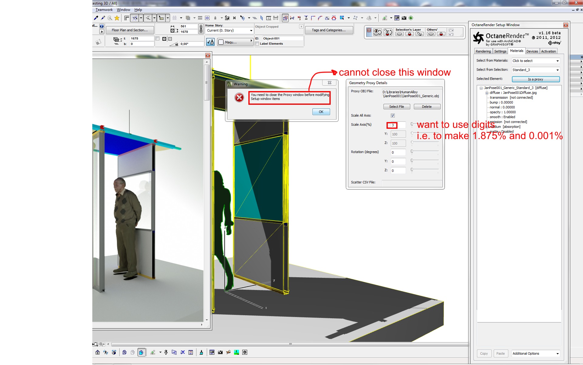

I am in a loop not being able to close the window.
I just noticed I was using the standalone 1.15; I'll download the 1.16 and report if I'll still this loop.
UPDATE
This was due using OR 1.15; I installed 1.16 ans I could close the window :D
Sorry to bother
And about the scaling: digits would be nice for two reasons:
1) I would like to be able and finetune between the numbers:
i.e. I need to finetune an outscaled OBJ to 1.875%
2) And secondly this gives the opportunity to smallscale objects to even smaller, like 0.01%
i.e. I like to make a citymaquette showed on a table ans I need to scale it very small to 0.00001% or something

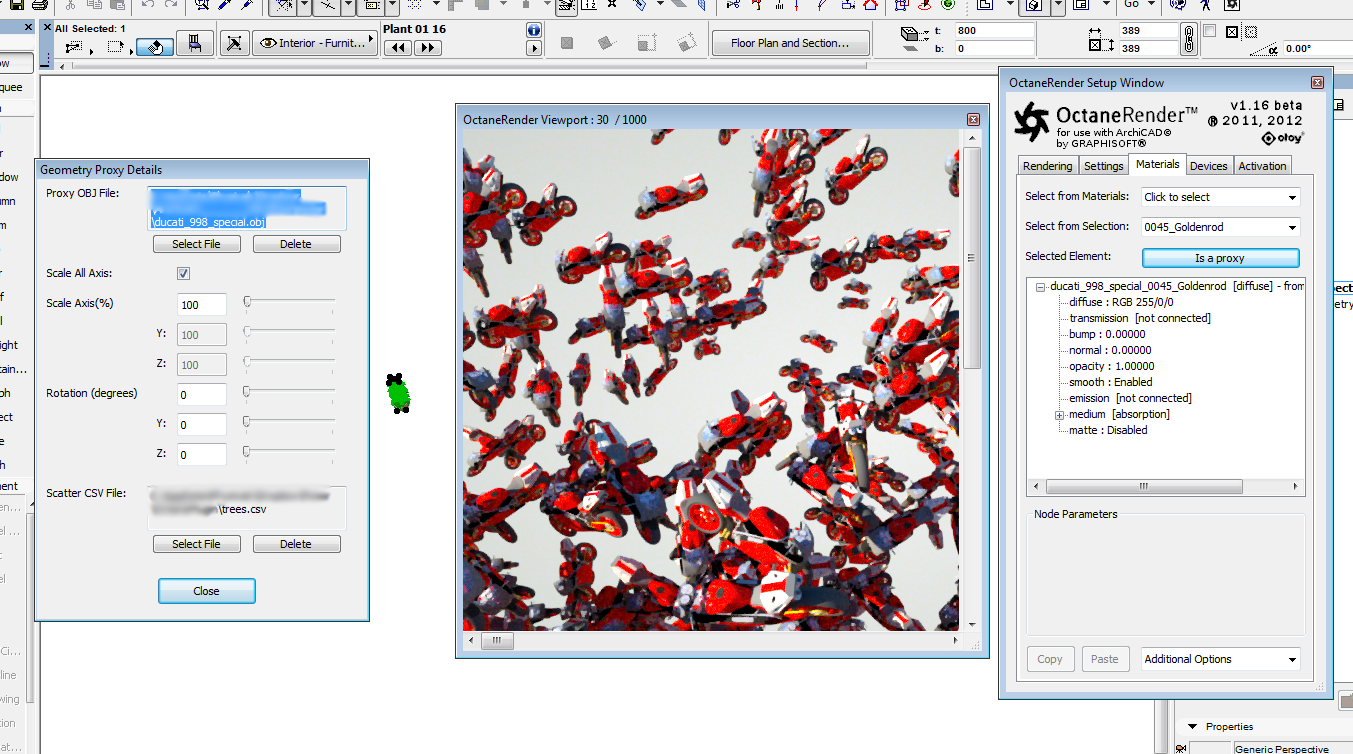

I started to test with csv and I bumped into the limit of 10000 transforms.
i.e. a terrain with 100x100 trees is 10000.
Can the limit be bigger?

face_off wrote:A couple of transform files you can try....
Paul
I used your csv files to see how the transforming works.. and it works Super!
This is mayor-wow-step in the plugin again; therefor big compliments for your work again :!:
Now back to testing: :lol:
When having the Geometry Proxy Details open it would be nice if it changes to the selected object when selecting another in Archicad. If not possible, maybe kind of a warning.
Otherwise it can be confusing when selecting another Archicad element, bu
changing another proxy, because I forgot to close the Geometry Proxy Details first.
UPDATE
Sorry to bother
I shouldn't matter which version of OctaneRender Standalone you have installed. This one is strange....
OK, I will make the digits able to handle fractions. The sliders will still be whole numbers.
Multiple selection and then linking them at the same time to one OBJ; is that a future feature? If not, that would be nice
Yes, that would be nice. At the moment there are issues that cause this to be difficult to implement - but I will add it to the "long-term" list.
I will make the limit 100,000.
I will need to make the plugin automatically shutdown the Proxy window if you select another object, because you are right - it becomes very confusing.
Thanks for the feedback. I will post the above changes in the next 24hrs.

face_off
Posts: 15809
Location: Adelaide, Australia
I just refreshed the installers above. Pls re-download and install.
1.16a3
- Transform limit incresaed to 100000
- Proxy scale and rotation edit box are now "double" numbers rather than integer to allow finer control. Sliders are still integer.
- Proxy dialog box automatically closes if you select another element
- Fixed issue where you could not close the window
Paul
