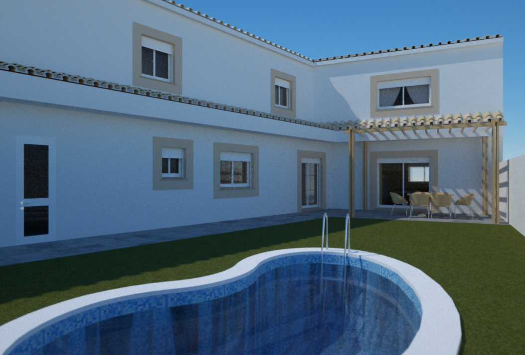

I have in the scene a pool and a terrain with SEO (terrain minus pool)... when I launch the render I have a some black triangules inside the pool... I try with path and DL whith the same result. Is it normal with Solid Element Operations? I think that I can convert the terrain to a morph a fix it manually...

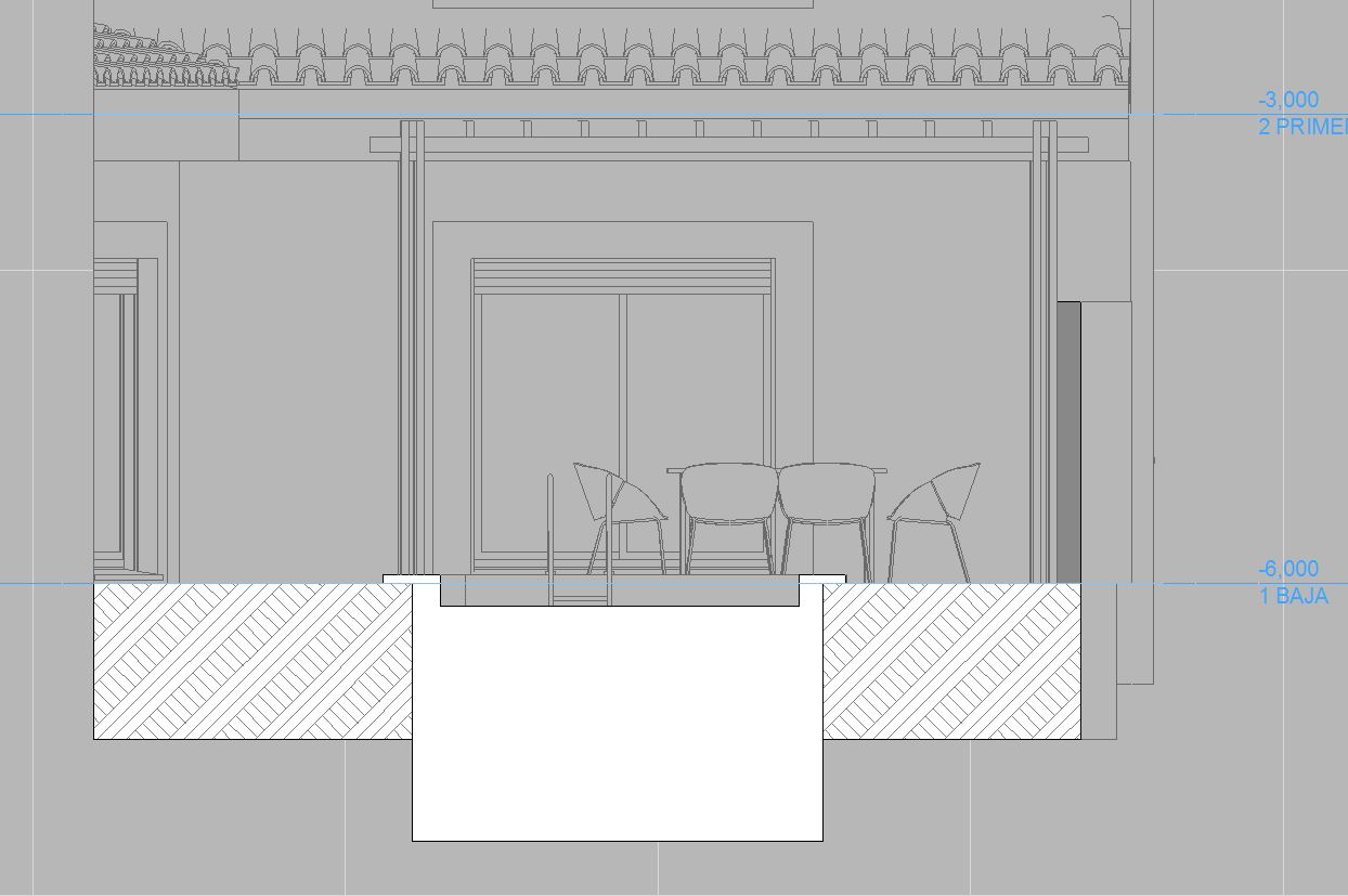

Can you tell me how thick is wall that separate ground and water in swimming pool.
Modeling is problem I guess, can you post a section from archicad of that swimming pool ? I think that ground is entering your swimming pool...i mean plane of ground is overlaping plane of swimming pool wall. How did you model water....is that plane only on top or it is 3d body ? :?

The ground its entering in the swimming, but It has a SEO to substract the swimming to the ground...

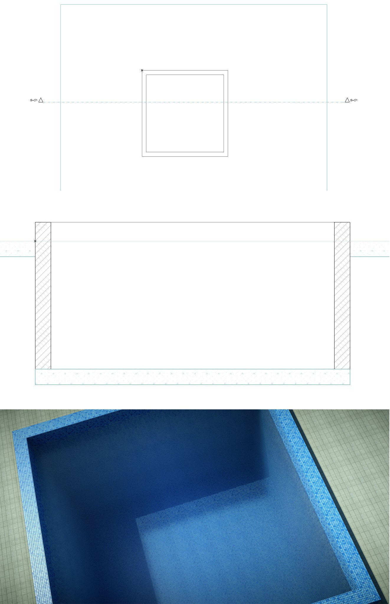

Wait a sec, i will draw swimming pool and render it without artifacts.

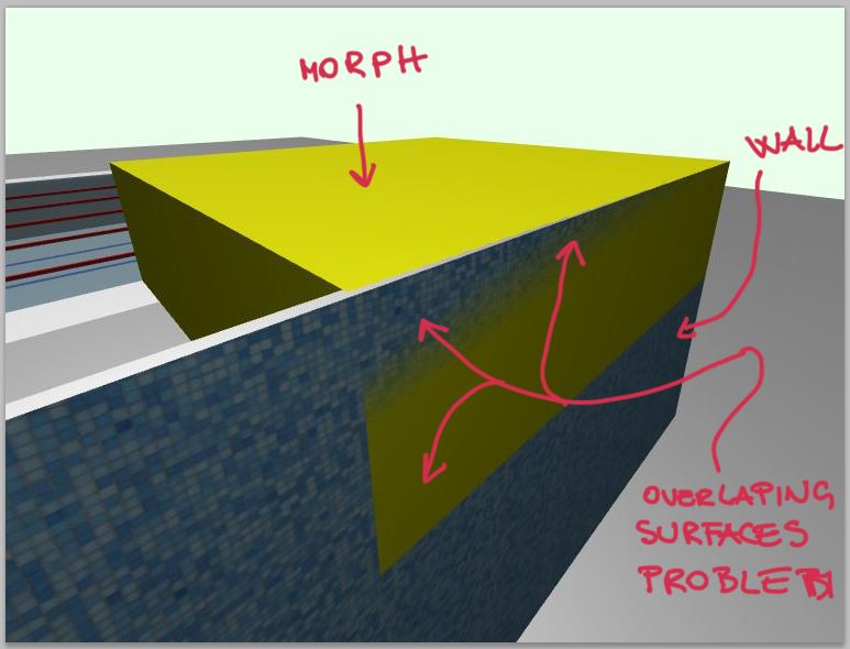

Avoid finishing 2 planes at same place...Look at section you will see that my earth is not touching interior of pool and i draw water as slab without thickness. Your water is somehow conected to the wall of swimming pool. If you use library object, delete it and model your swimming pool with slab and wall
Draw your pool with wall and slab and don't bother with earth...draw it like slab with thickness of 30 cm
Look at Blender artist how they arrange scene drawing it with planes.
I didn't have more time to model something better but i think that you will draw it and render it RIGHT after remodeling your pool

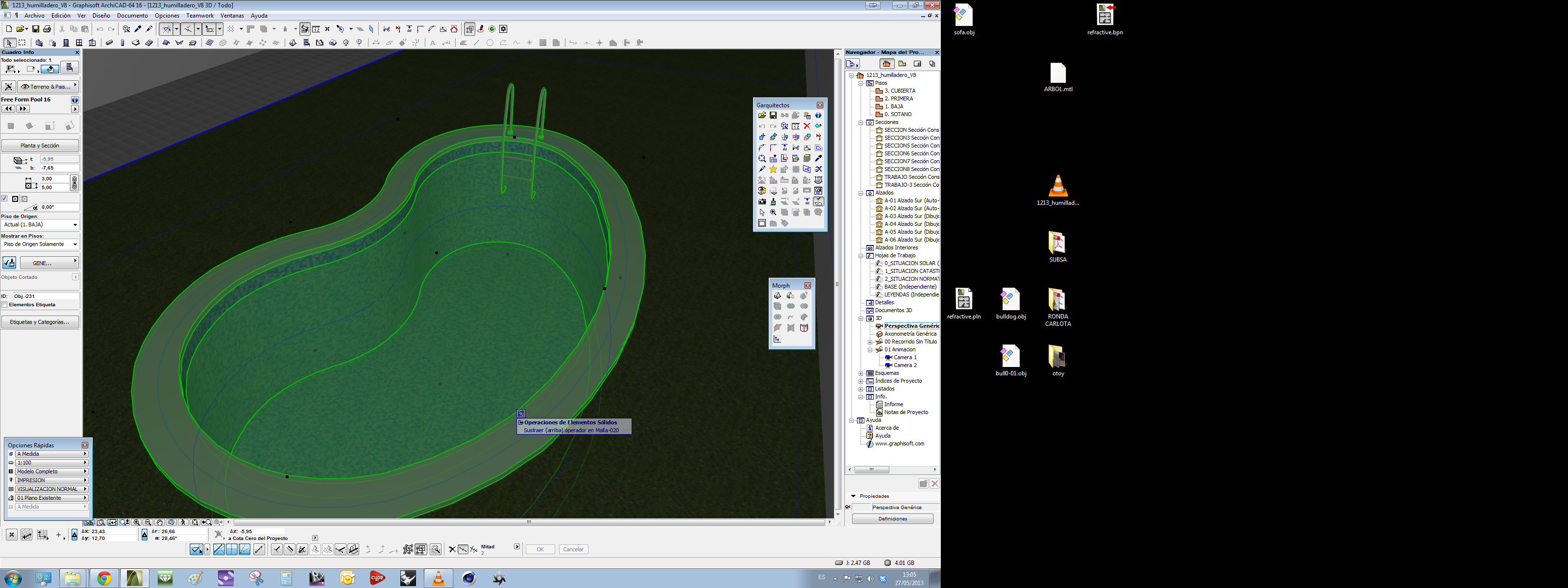

I dont understand well... the swimming is a GDL object, I never will draw a pool with planes in Archicad... Archicad its a BIM software, if I dwaw the swimming with planes then I can't do schedules...

Draw it with walls and slab or
when you need to do presentation, copy your original archicad file, then edit it to be compatible with rendering laws :) (there you can change everything and adjust to render properly cos BIM is not important now because you are making changes on copied file !
Or simply use bigger SEO object so that you cut more ground around swimming pool by 1 cm so that ground don't touch swimming pool and error in BIM (calculations) will be irrelevant
- This is your error, you are using GDL object for SEO and its not working because face of wall and face of earth are overlapping...Octane can't determine which one is in front !
I know its BIM but remember this is rendering software which is different in every way comparing to BIM. Octane Render is NOT aware of BIM information.
There are many workarounds for your problem, just pick one...
