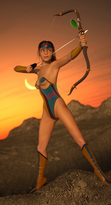

Attached picture is an example of how it would look. Used the glasseye sky dome (sharecg) with one of his addon textures. I set the sun low and changed to red sky and red sunset

Great workflow. Thanks Wim.
