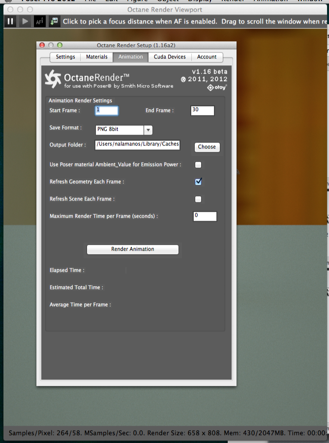

Also, would it be possible to post some screen shots of the plugin in action? I'm seeing some wx.python user interface oddities, but not sure if that is simply use to using VMware.

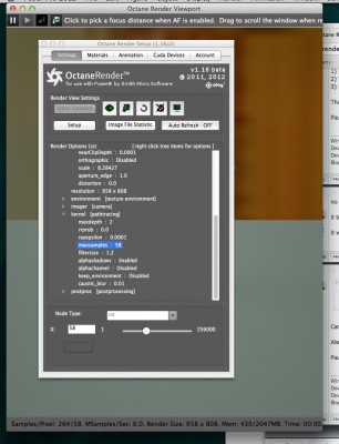

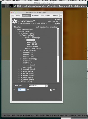

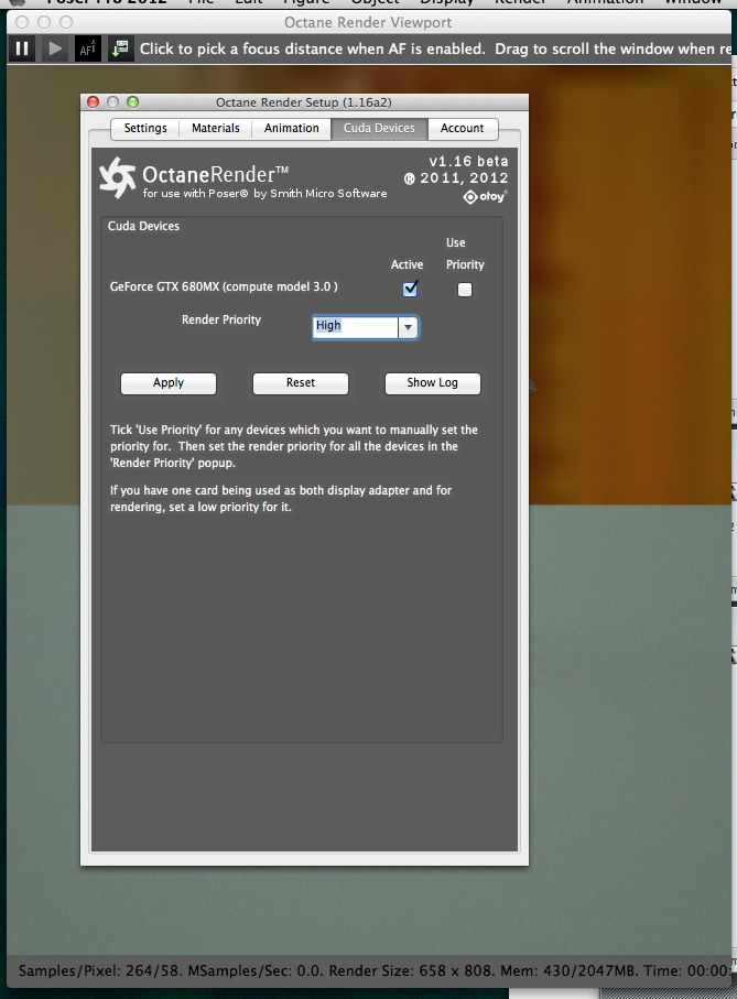

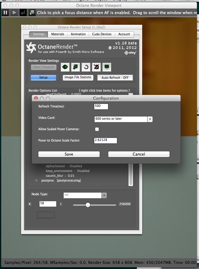

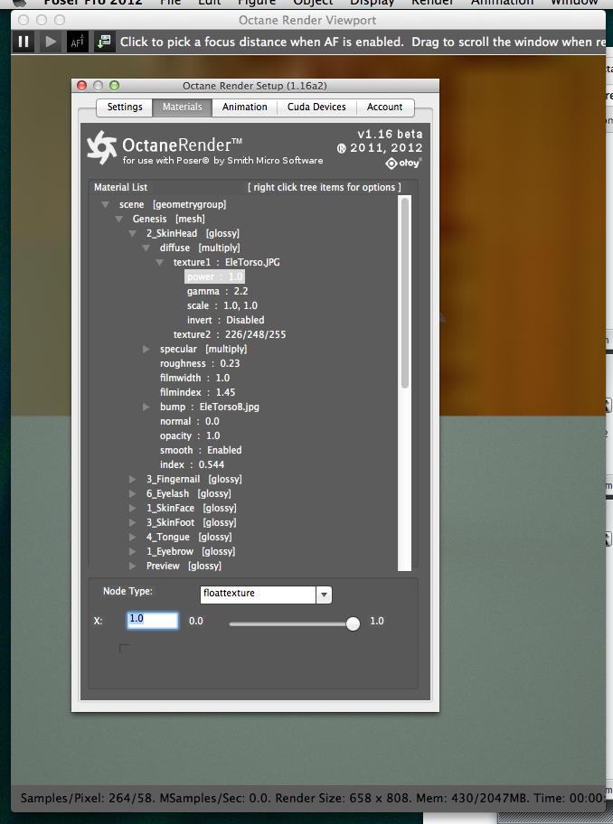

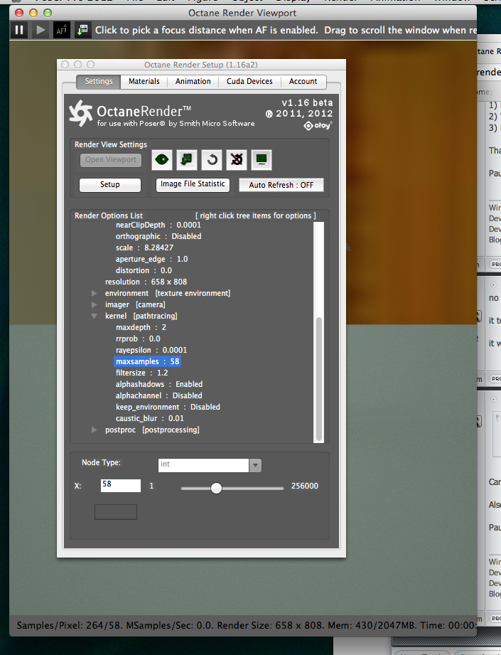

changing the aspect ratio does not cause the crash anymore, it seams almost random. just touching the interface will cause it to crash. The crashes will only occur after 20 or so minutes of work. and always at different times and actions. I haven't had too much time to play with it this weekend, but I will keep you posted.
as far as screen shots of the plugin in action. I posted a few, let me know if this is what you are looking for.
Asus Z97-A / usb 3.1 - Windows 10 - 980 ti - Titan Black - Titan Z - Daz Studio
Thanks. My concern is some of the GUI element not painting correctly. For example the black box on the last screenshot (at the very bottom) is no where near aligned to the text edit box. Whilst it is only a cosmetic issue, it's still a very rough.
