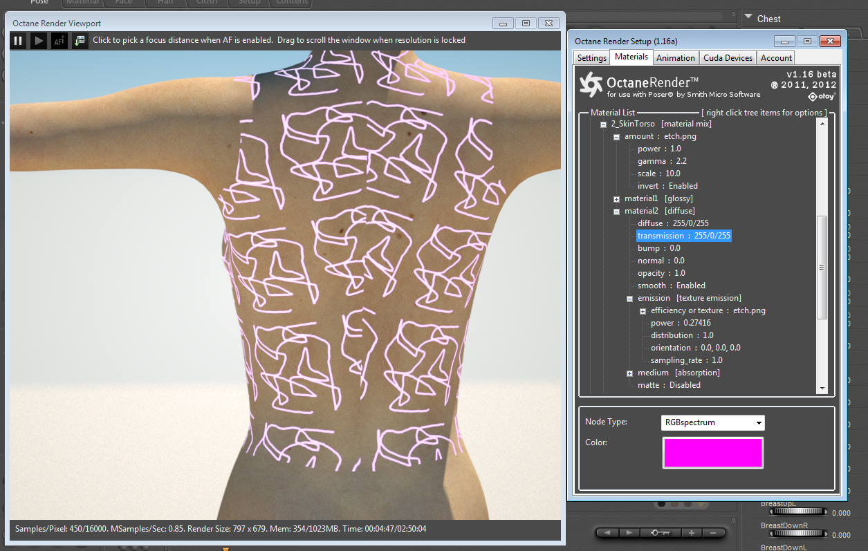

At a guess, I would say their skin texturemaps are a mix of a skin map and an etch map, so the plugin is correctly picking up the skin map, but not the etching map. You should be able to get a very good effect with these maps by manually adding the etch map into the standard skin shader.
1) Copy "SkinTorso"
2) Convert "SkinTorso" from glossy to material mix
3) Paste copied material into "material1" (restart the plugin, since I need to fix an issue with pasting materials into material mixes
4) Plug etch map into the mix "amount" and invert
5) For material2, setup the "diffuse", "transmission" and "emission" up as per screenshot below.
Paul

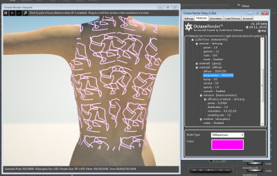

I managed to get it working sort of but not with colour like you specified. I'm honestly doing something wrong quite White working out.
I know you extremely busy at the moment so I'll leave my settings here and when you have more time if you could help me out. I would greatly appreciate

Would it be possible to post the material tab screenshot (from the plugin) of torso material pls?

Oooops, sorry. You are missing the top level material mix. The key is that the etch texturemap (etch.jpg in my screenshot) goes into the "amount" pin of the top level "material mix". Then material1 is the standard skin glossy, and material2 is the emissive lines.
