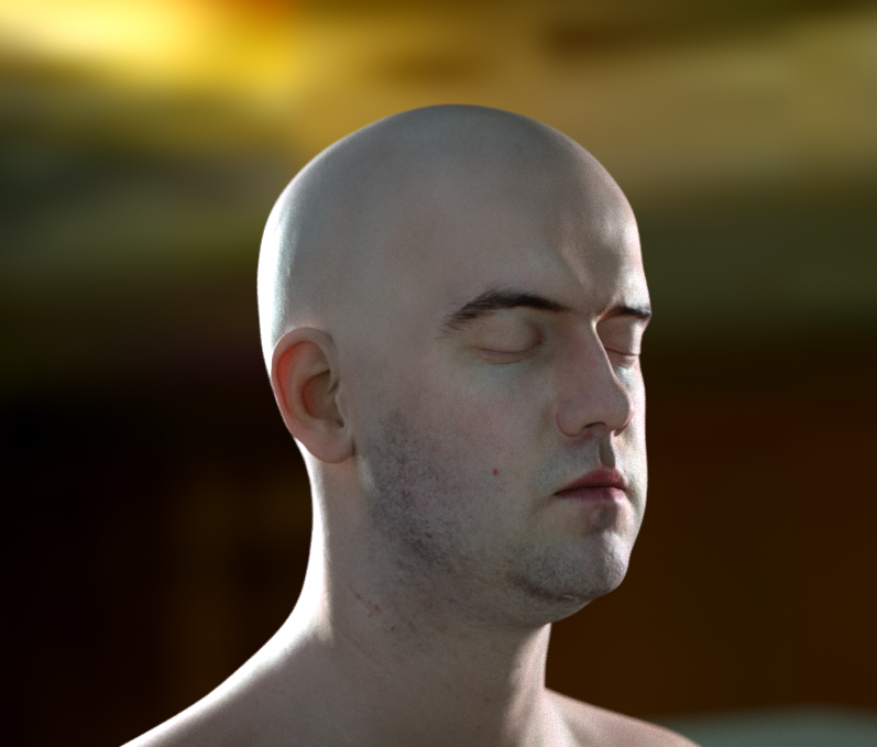

face_off
Posts: 15813
Location: Adelaide, Australia
Fixed SSS!

I need to check - but I suspect the old bump power settings the plugin was using for skin will now be too high. Will be interested to hear peoples thoughts on what the right bump amount should be now.
