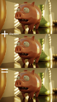

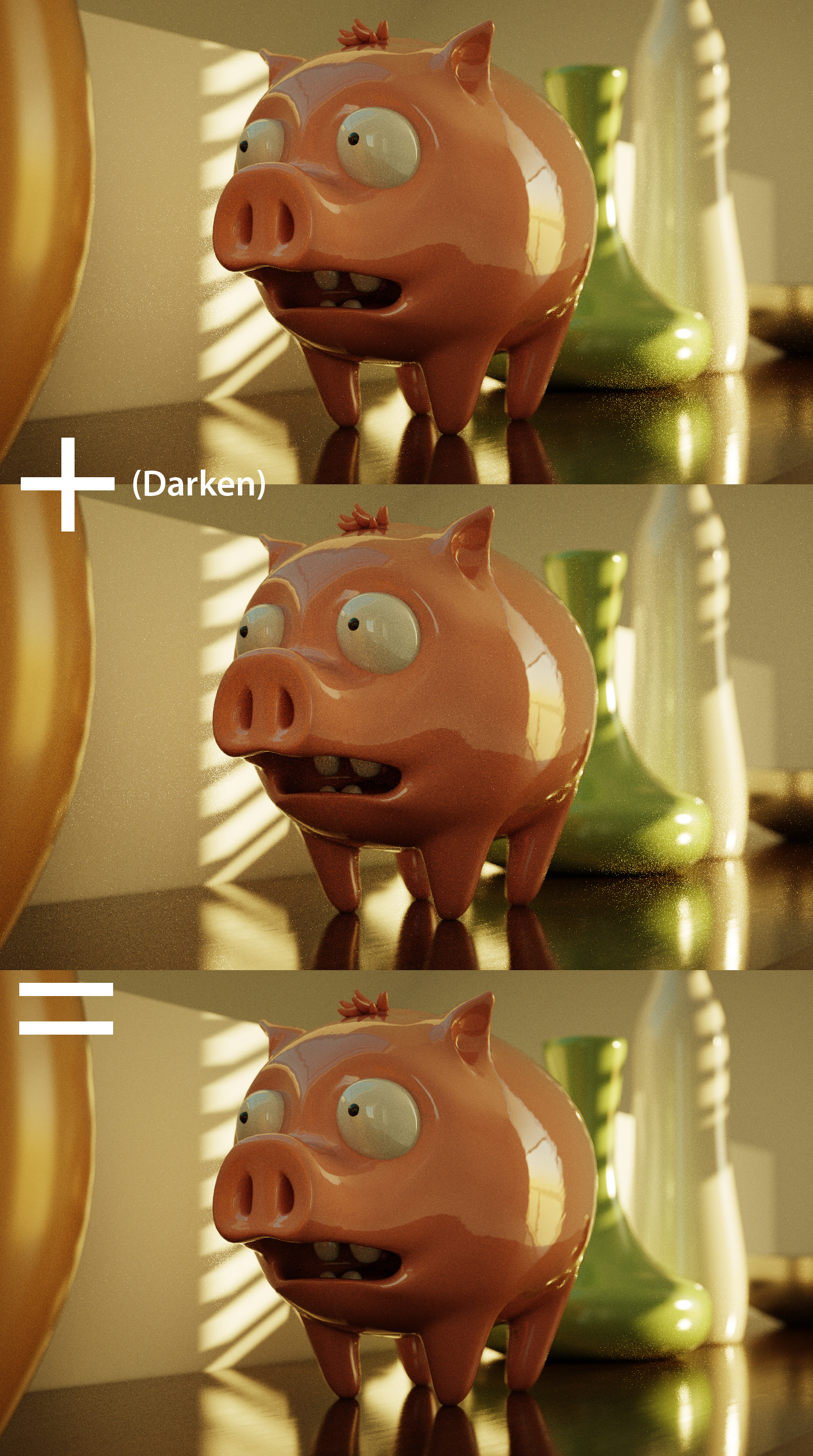

Is it possible to implement some kind of Multipass feature - when octane would render several passes with different seed and then merge them together to reduce noise and fireflies. I think it's much more efficient to render 2 (or more) passes required resolution (for example 640x480) and merge them together usind mode when less bright pixel is chosen (it's called "Darken" in Photoshop) than manual FSAA (Full Screen Anti Aliasing) method. In first case 614.400 pixels is rendered (640х480х2passes), in second case 1.228.800 (1280x960 - double resolution). Similar method is used in maxwell distributive render - each render node computes same frame (but with different seed) then all pictures are merged in one frame (in this case arithmetic mean based method is used I think). "Darken" method was already discussed here but it's really annoying to merge images manually - could it be done automatically?

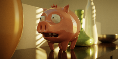

I attached some pictures
We can see what in this case FSAA 2x isn't enough - image still too noisy.

This could indeed be a solution for faster "de-noising". Nice idea
Maxwell already does this automatically with dist.rendering so i it should be possible to do with Octane also. One obstacle would be to have several framebuffers in vram at once.
