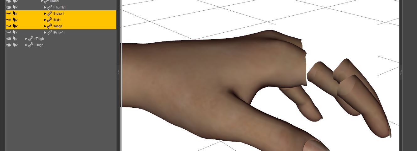

actually that is not what the OP meant. Since I have the same problem.
For instance I can hide a single finger in DAZ but in Octane it will still show. This is not a material issue.
I have made the same statement in my post on the current issues.
While I can hide materials, it is sometimes required to hide certain parts only. Luxrender can do this
I am attaching a screenshot for reference
Once again, this is not a material issue

exactly, hiding surfaces is not an issue. The problem is when I hide geometrie in Daz it still shows in Octane render. And sometimes for instance a hand has several objects which I can hide parts of in DAZ, but in Octane I only have the option of hiding the surface map "hand"

hi 3dmania!3dmania wrote:exactly, hiding surfaces is not an issue. The problem is when I hide geometrie in Daz it still shows in Octane render. And sometimes for instance a hand has several objects which I can hide parts of in DAZ, but in Octane I only have the option of hiding the surface map "hand"
the standard geometry access through the ds4 sdk doesn't provide bone meshes any longer (as it was the case with ds3), so this isn't right away possible. having some talk with daz about that already, there might still be a way to achieve it though. only it is again fiddling around in a non-standard way and i have already (too) much of that to accomplish things that are not directly supported by either octane or studio (and lots of headache because of that), so i will put this in only if other problems are sorted out, sry!
