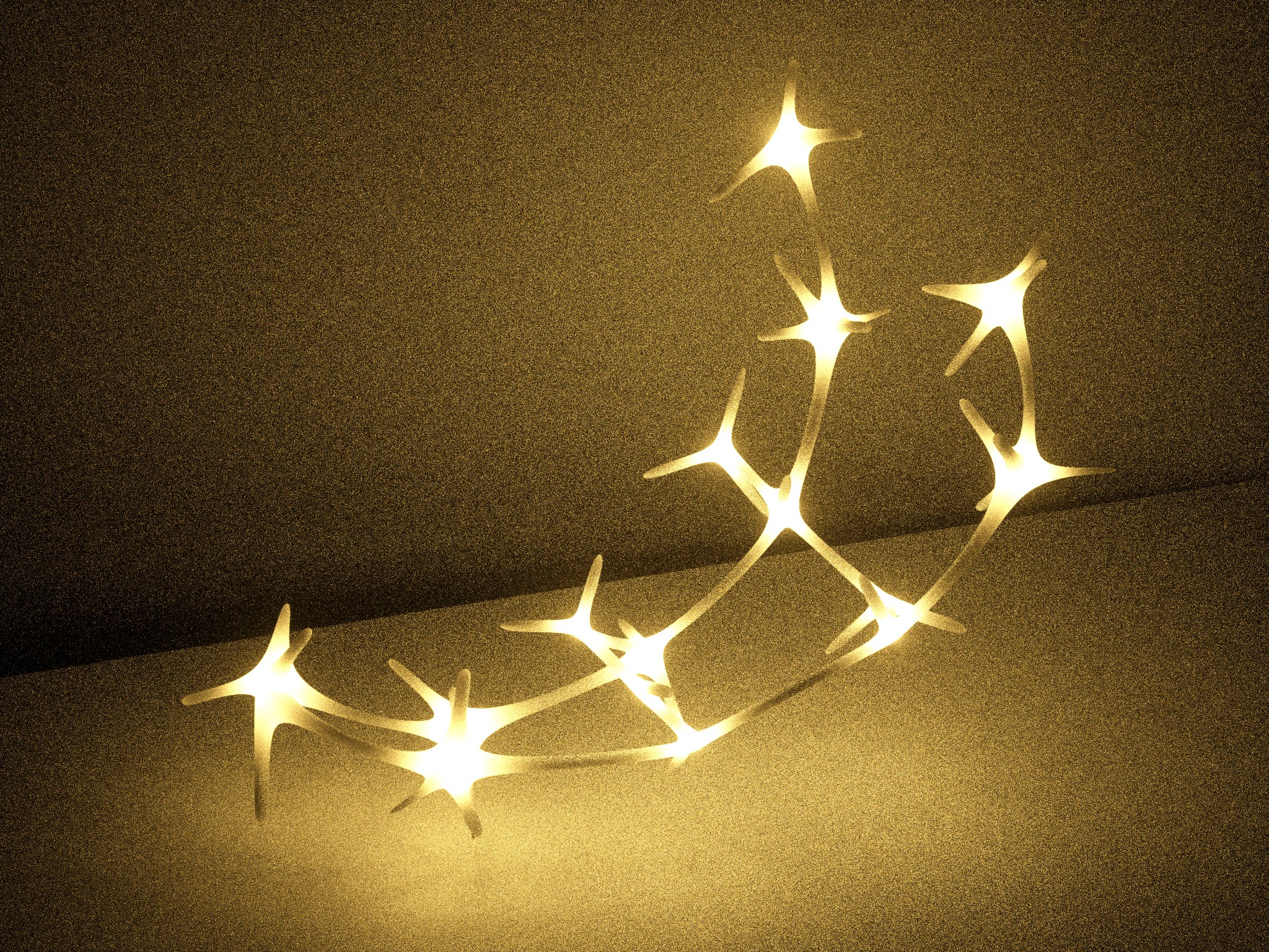

Hi mbetke, jamnique and Chris,
I have attached a Max 2010 scene that is part of a much larger scene, the screenshot is a 30 minute render on a GTX590.
Imagine this scene times 50, then you would have the actual scope of my scene setup.
A reason not to use a transmission map is that it takes too much time to paint a transmission, especially on an object as this it is quite impossible.
Another is that we want to see how the lights actually penetrate the meshes, and using an unbiased renderer is of course ideal in this situation. Biased 'tricks' just don't give a realistic image. And moreover, in one scene that light output is animated or moving.
Always when I try to render indoor scenes with 10+ lights I encounter masses of fireflies.
I would like to know if it is merely render power that I need (for example the Octane cloud render system) to get a smooth firefly/grain-free render, or that Octane isn't (yet) equipped to render these kinds of scenes.
Thanks for the feedback!

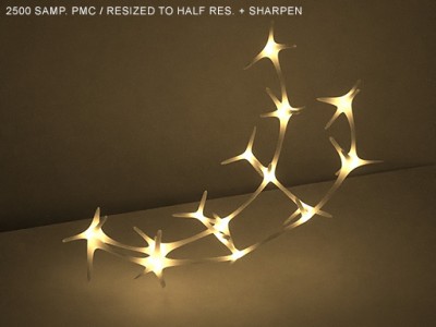

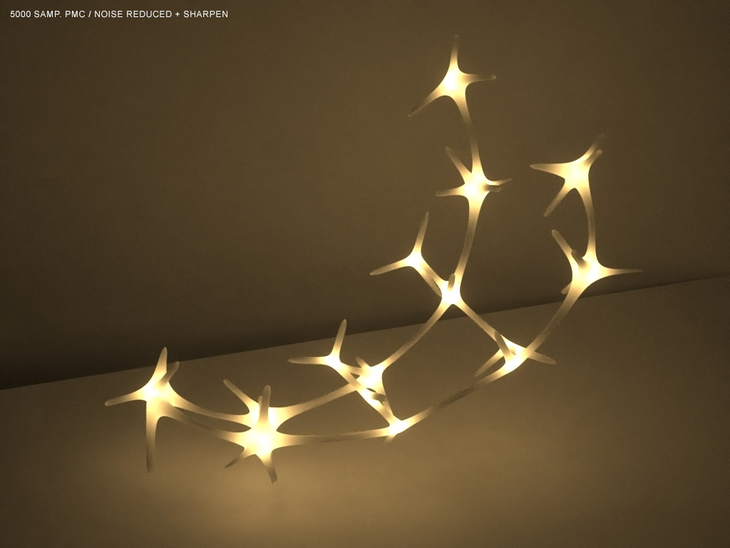

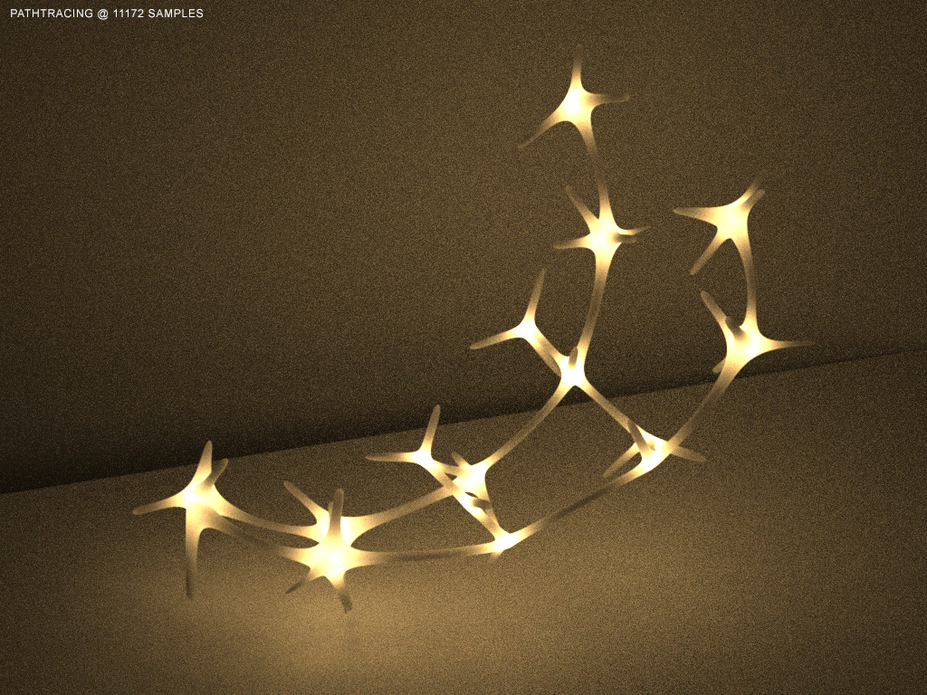

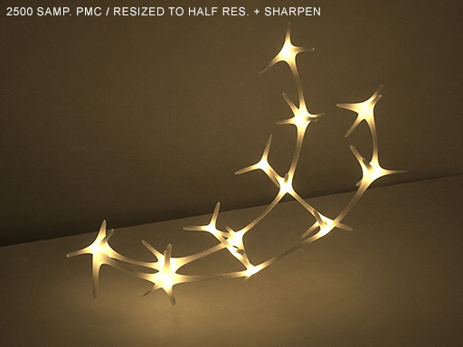

Thanks for the scene.
I made some tests and changed a bit here and there. This is what I got:
I rendered not at the pre-defined 2048px size from the file because it took a bit too long but at 1024px which was the same in a visual way.
What I did:
- Switched all lights visible = OFF
- Added invisible fill light plane to give some more ambient light. A photographer would do the same so I think it is legal and it stays unbiased.
- Changed light samples to = 32
- Changed to PMC
- Maxdepth = 8
- Caustic blur = 1
- Changed imager to Exposure = 1, Gamma = 2,2, ISO = 250, Response = Linear
On Photoshop I made a quick reduce noise pass, reduced size from 1024px to 512px (only on 2500sample image), sharpened the image slightly.
If you would put in some glare or bloom later in your "real" rendering then the noise would vanish even more I think. Depends on your scene. I guess if you would cook the image to 10000 with PMC it will be fine. With 16k even noise free.
