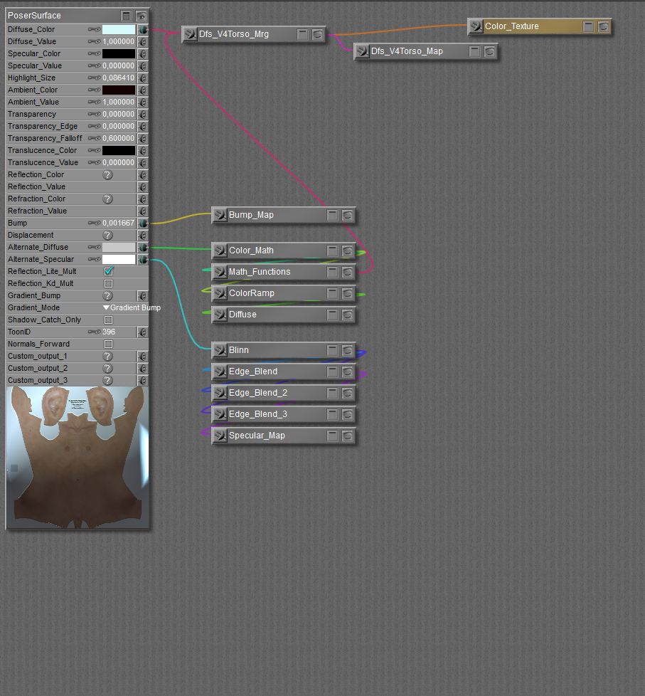

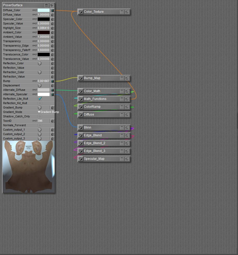

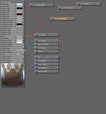

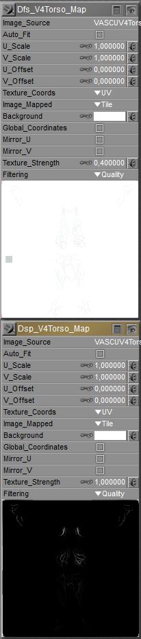

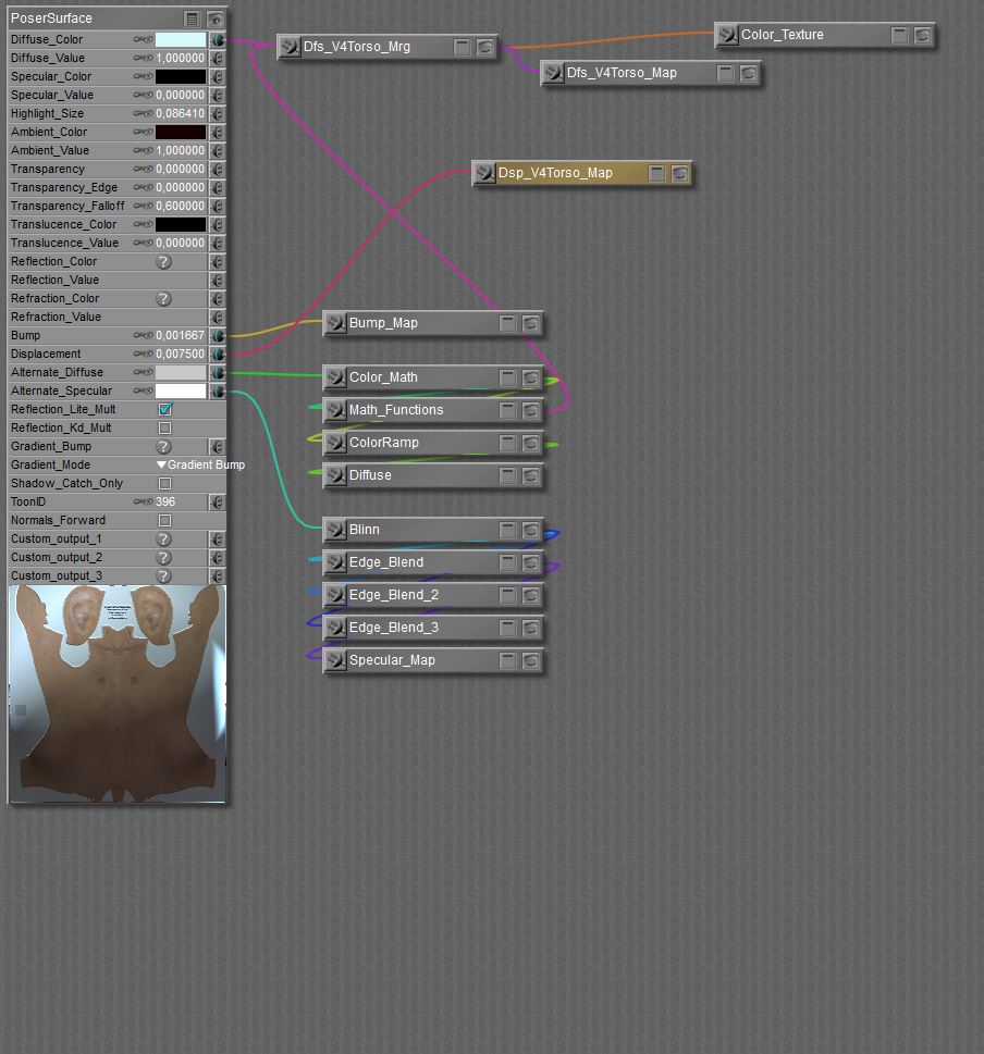

Would it be possible to see what Dfs_V4Torso_Map and Dsp_V4Torso_Map look like pls? Just flip open the preview of those nodes - that will give us a better idea.
Paul
Paul
Mmmm, I'll be honest....mixing one texturemap with another via nodes is not going to get you the best outcome. Whilst you could convert the backgrounds on the images to alpha and get an OK result, it's probably not something I could walk you through in a reasonable amount of time (and the outcome would still not be that great). Much much much better to purchase an M4 texturemap with veins on the actual skin textures. Or you can photoshop the ones you have purchased onto the standard M4 textures. The results will be way better.

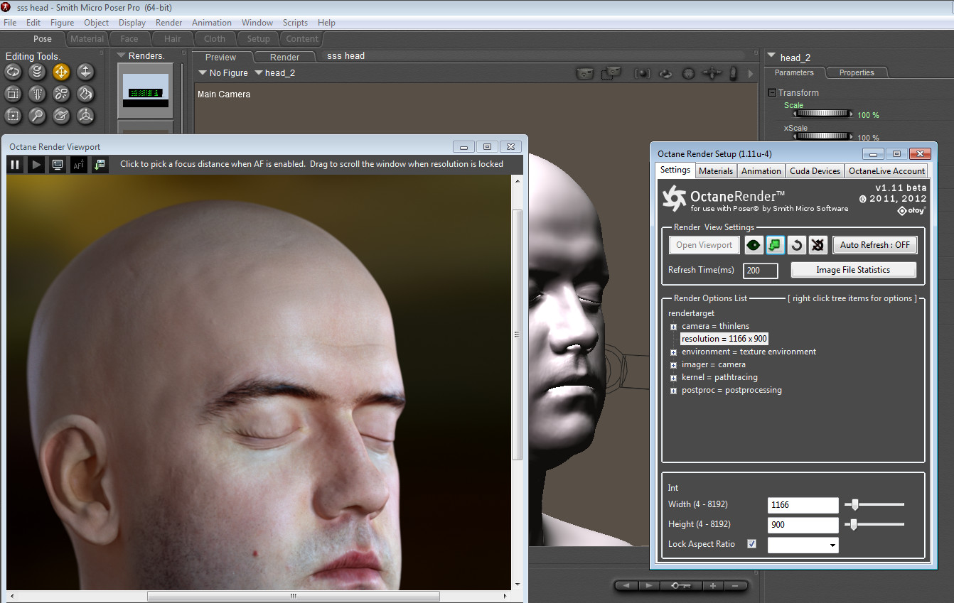

Well... It looks pretty nice with the firefly renderer... Special in the M4, in his arms, looks like he's really lifting weights, because the kind of pump out of the skin a little bit. I guess that's the displacement right? I think I won't get that effect in photoshop, right?
Yes, that is probably the displacement. Hopefully one day soon Octane will be able to do displacement. In the meantime, if you are keen, you can use "normal" maps - which is what the attached image uses. You can use ZBrush to convert from displacement to normal maps (unfortunately there is not an easier way).
