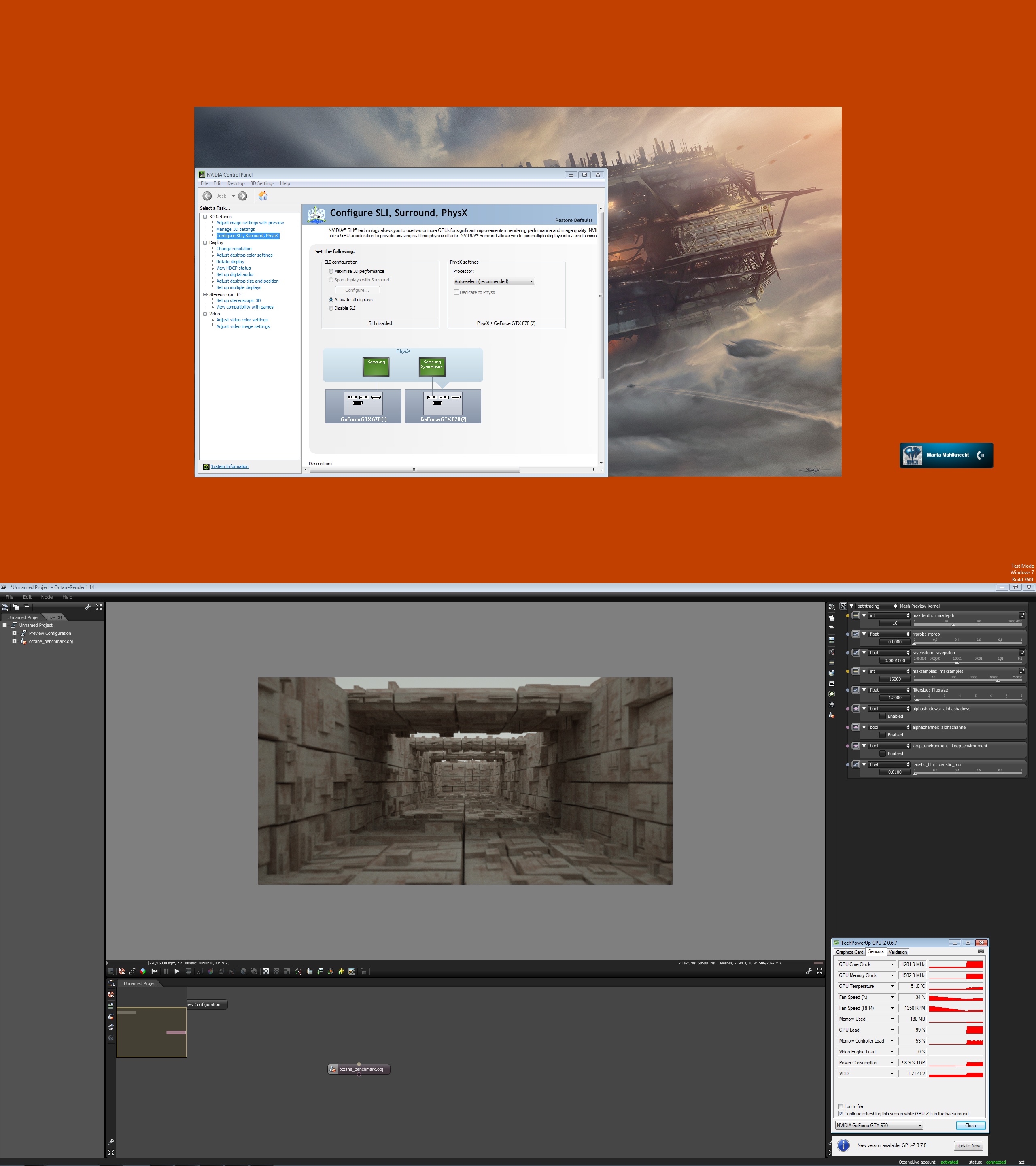

I hope Ive done it correctly or im using the correct version. Anyone got the link to the current one.
RedSpec TGX for Poser / OctaneRender - OUT NOW visit http://redspec-sss.com/
