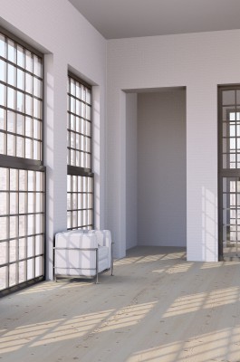

Hello,
Direct Lighting 3,
Tests... Hope you will like it :)

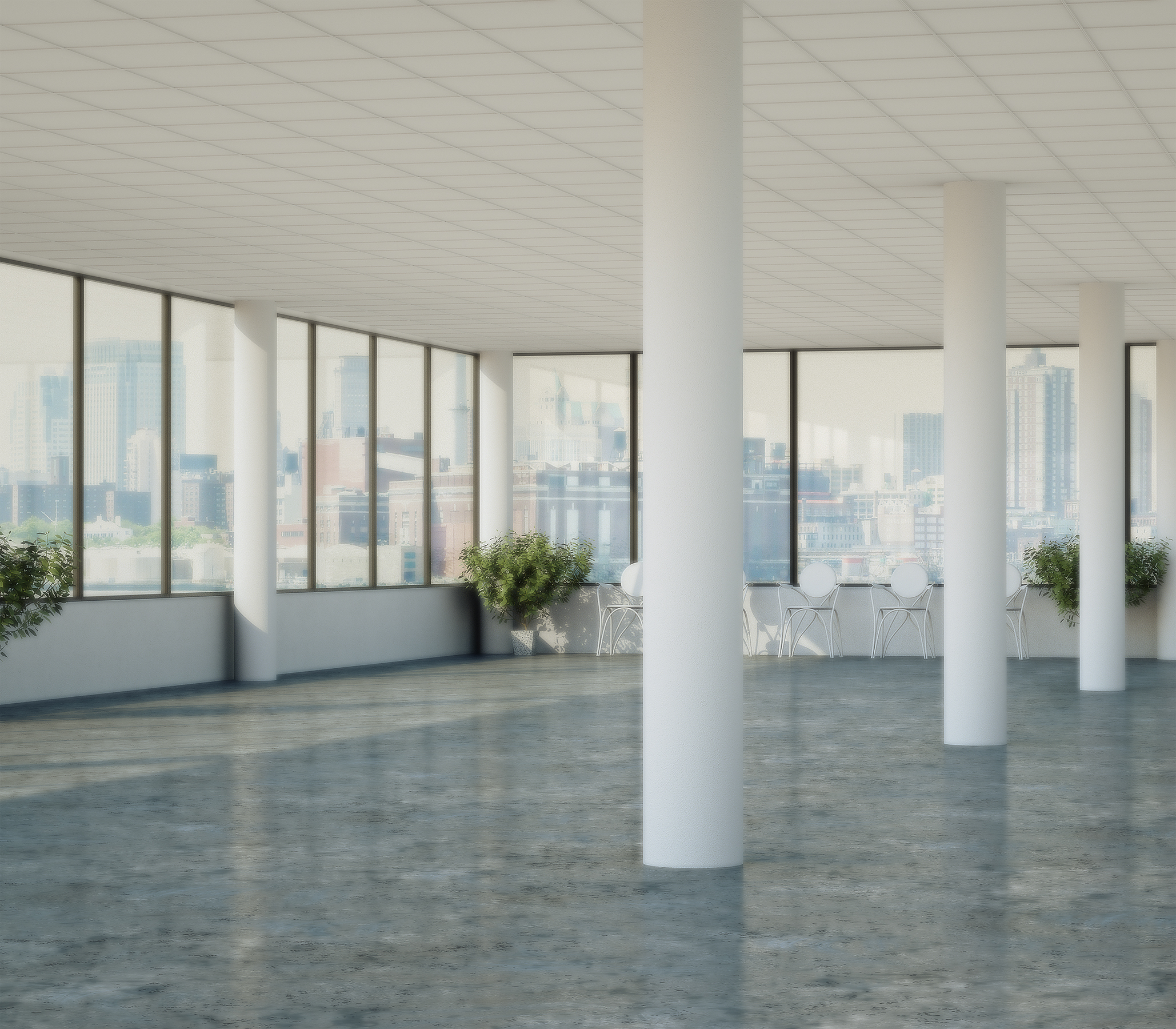

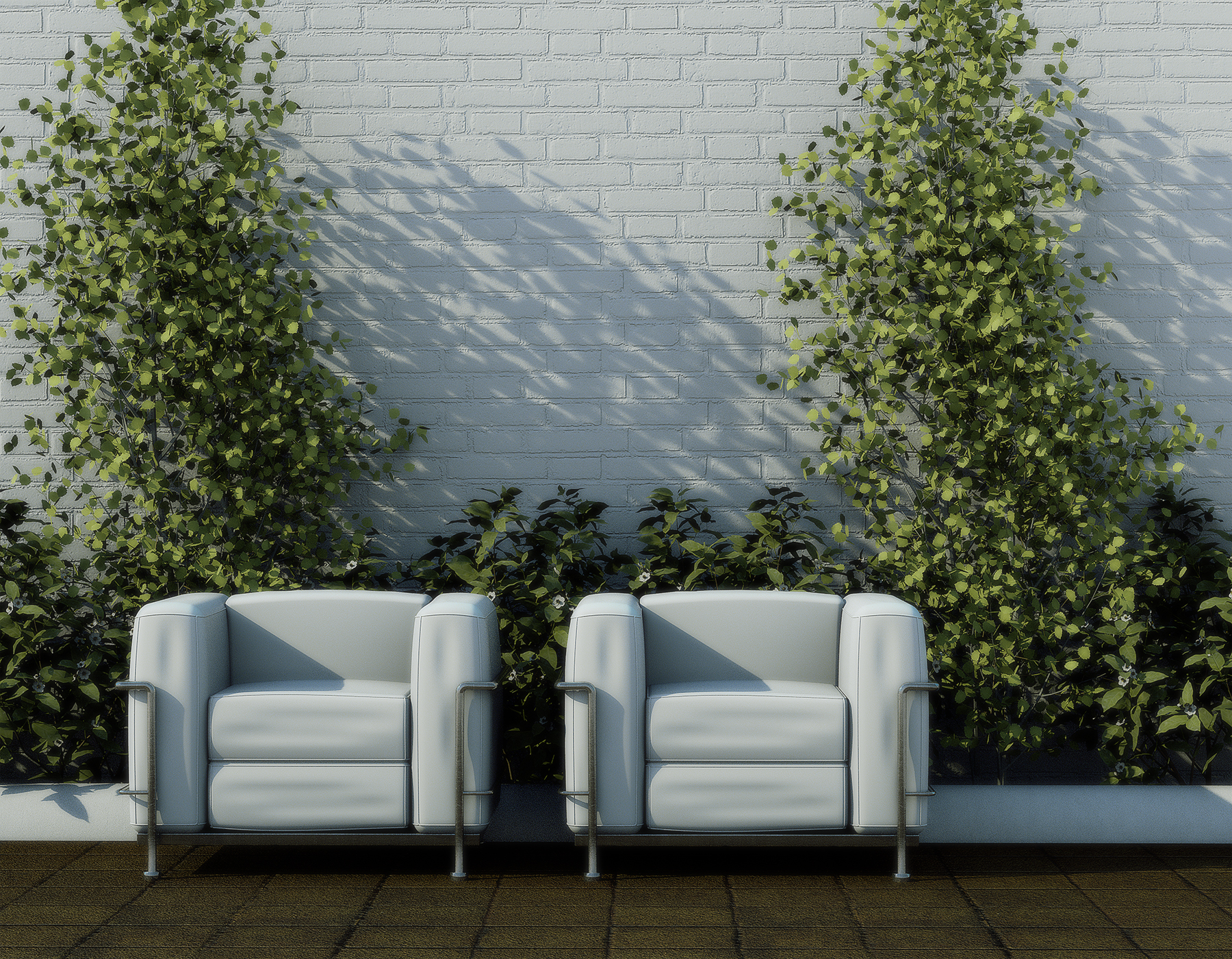

Hi Cadvis,
I do like the 03
02 has strange size, not square, not widescreen, maybe not even 4:3?
And is cut strangely halfway plant.
03 is more stronger in chosen scene,
But 02 shows the sun shining inside nicer.
I like the overall bright look.
Greetz,
I do like the 03
Greetz,

really nice images Cadvis.
Really a good natural lighting, int the image "02" the floor looks quite strange but in general the scene is cool and can be confused with the "make of" of Enirco Cerica's Belgian compromise...this mean that it's a really good job
The illumination it's a mix of Daylight+HDRI?, both in AO mode or one of them is in a different kernel?....I really don't know how you can reach the same kind of white for the walls and the ceiling in AO mode
Cheers, Paolo
Cheers, Paolo

Thanks Guys for your comments. Much appreciated.
At the moment I'm doing these 'tests' to find the way how to make renders like Enrico Cerica
. If he is able to achieve such a nice results that we should be able to do it as well (close ish
). He is an inspiration.
The settings are standard - HDRI & SUN mixed together.
Exposure: 2.3, ~ISO200, response:dsc315_2, gamma 1.0. (settings same for HDRI & SUN apart for the environment power:HDRI 1, SUN 0.1). Rest is postpro (curves, blur, white color etc). Samples 200 for each. Time (overall with postpro - 20-30min).
- paoloverona
- Posts: 435
- Joined: Thu Mar 29, 2012 8:40 pm
thanks for sharing your settings with us Cadvis
