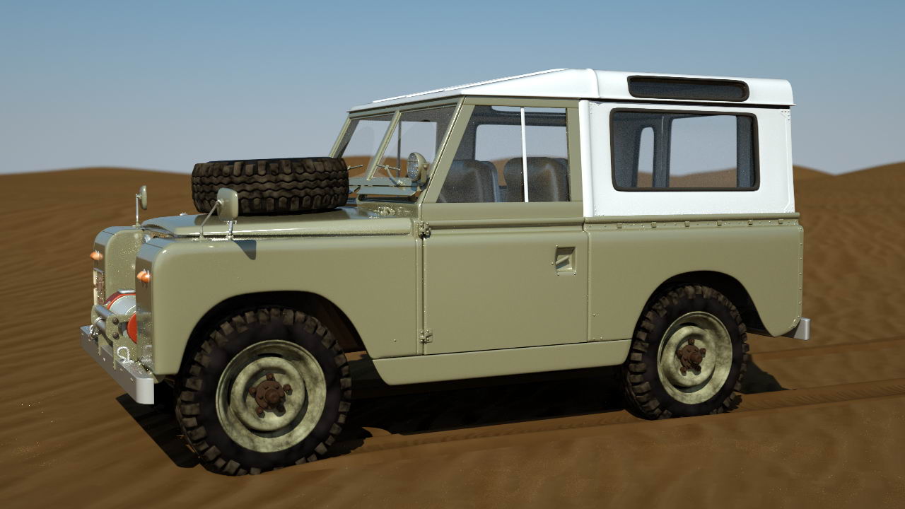

I opened an ocs file in Octane 2.2 and relinked the new geometry. After that I modified some materials and added some nice procedural textures using Turbulence.

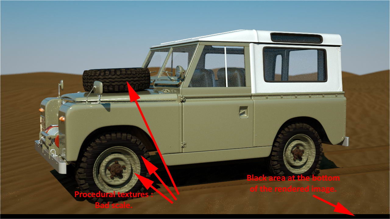

I saved the scene, and opened it in Octane live pre-2.3. It opened but the procedural Turbulence textures are destroyed : Colors and scales are bad, and I can't setup good textures again.
Attempting to correct the textures by using the 3 scale cursors in the Turbulence panel leaded to the usual crash : white half transparent screenand freeze !
Examples below. First image rendered in 2.2. Second image loaded from same ocs, and rendered in Pre-2.3. The second one is a screen capture because I get a crash each time I attempt to save the png in Pre_2.3.
Pre-2.3 Turbulence textures destroyed and crash when scaling
