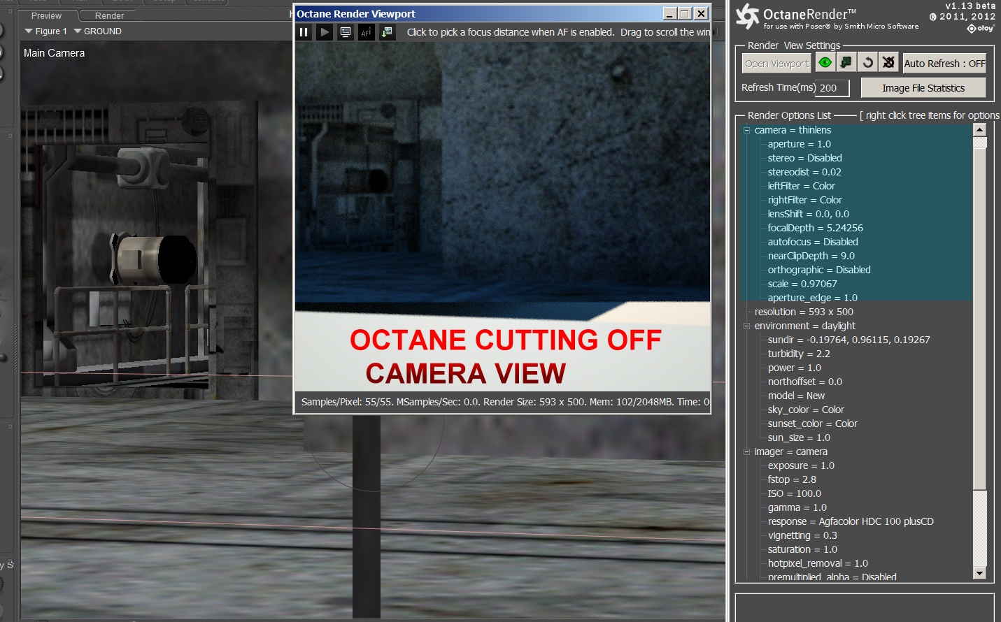

Hi Gold - would it be possible to post a screenshot pls? And include the Poser camera parameter dials in the screenshot pls.
Yes, screen shot attached. This is a different set up. Worse, because Everything looked fine for the animation setup, but after it got going these render problems started appearing. { this is about frame 25 of 90 frame animation . Frames 25 -50 approx, were bad. }

Thanks for the screenshot.
In Poser, the camera lens is approx 1m behind the actual camera coordinates, and any geometry in between the camera coordinates and the lens is ignored. So in effect, there is a blind-spot between 0 and 1m from the camera lens.
To represent this in Octane, the plugin transforms the camera 1m "back" from it's current Poser location - that puts the lens positions at the same points in space. However because the Octane camera coordinates are behind the Poser camera coordinates, sometime geometry will get in the way of the camera and the subject you are rendering. I think that's whats happening here. I can fix this by adjusting the Octane "nearClipDepth" - make it bigger to ignore geometry further out from the Octane camera.
Hope that explanation isn't too confusing.
Paul

Actually, you probably need to REDUCE the nearClipDepth rather than increase it - since it looks too high. Anything - try adjusting that slider and see the outcome :-)

face_off wrote:Actually, you probably need to REDUCE the nearClipDepth rather than increase it - since it looks too high. Anything - try adjusting that slider and see the outcome :-)
What? Wait a sec, I'm getting worried now. Is this a permanent fix you're planning to perform?
I just tested it, and this looks impossible for a user to perform, as is.
I just tried that near clip depth. Yes it worked, barely. But the control is extremely hard to adjust, hard to
calibrate, and with a razor thin room for error. But worse, my testing shows an animation would have to have multiple keyframed positions. Time consuming, iffy, and frustrating at best.
Please correct me, that you can do a permanent fix here.

face_off
Posts: 15814
Location: Adelaide, Australia
In this case it's the Poser camera which has some irregularities, not Octane or the plugin. In essence, the Poser camera is looking though walls. So if you are animating camera movement inside an enclosed area, Poser is going to look through some walls that Octane will not. It is only Poser "Revolving" camera that do this - "Dolly" cameras do not. So using a dolly camera will help, although the Octane Viewport camera matching is not as precise with Dolly cameras as it is with Revolving cameras.
There is another trick you can do - you can adjust the Poser camera "Focal" slider, so that the Octane field of view "fov" widens. That in effect means you can take your Poser camera closer to the subject, so fewer walls will get in the way.
