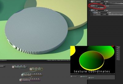

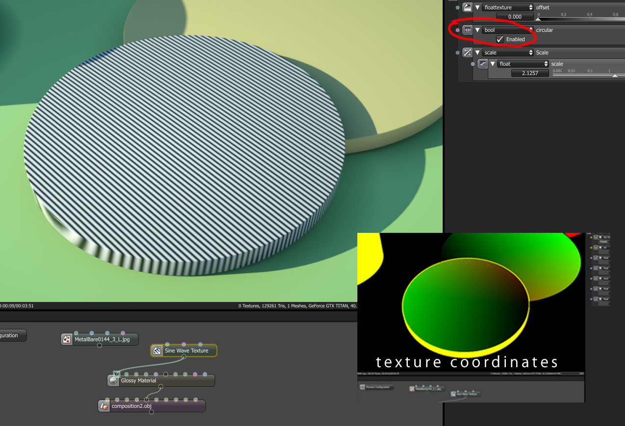

The problem is shown on the screenshot.
It seems that the center of the pattern is far away from the object center (or texture center?). I checked whether this issue is due to the exporter - 3ds max and sketchup - I get the same results.
The problem is gone when the exported object is centered at origin (0,0,0).
Is it something I am doing wrong, or this is a bug? How to set the center of the texture to the center of a circle?
Circular sine wave texture problem

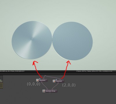

And here is confirmation that the center of the circular sine wave pattern is always at global origin. I used instancing - for the placement at origin the center of a pattern is as it should be. For the second instance the center of the pattern is still at origin, instead of in the center of the instance.
Is is intended? Can it be fixed to get a center of the circular wave texture located at a center of an object?

Procedural textures are 3D but use world coordinates origin 0,0,0 you must offset position manually (in standalone) if you want to use it.
And the worst is when you use it with object animation, textures "slides" on it because of the lack of uvw linking (it remembers me my first test with a checks node on cube).
Never heard if they want to do something in a next release to correct this (correct me if i'm wrong).
the only workaround i've found is to use 3D procedural from cinema 4D and convert them into maps, now that i've got C4D plugin i will try to link object coordinates to textures with a little Xpresso node.

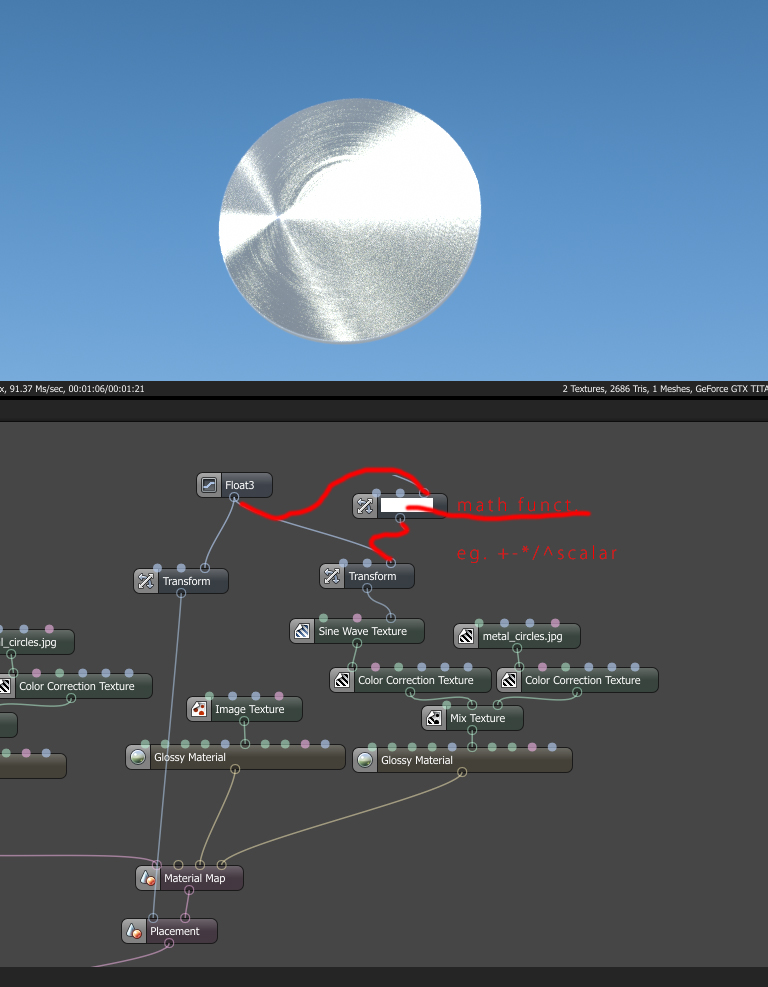

I tried - no way to set it in this caseLudovicRouy wrote:... you must offset position manually (in standalone) if you want to use it....
That would be such a loss. Please take a look at next render why I need it so badly. I can reproduce one such disk, at (0,0,0) but I need them more in my model.LudovicRouy wrote: Never heard if they want to do something in a next release to correct this (correct me if i'm wrong).
OCTANE TEAM please fix it asap if this is possible.

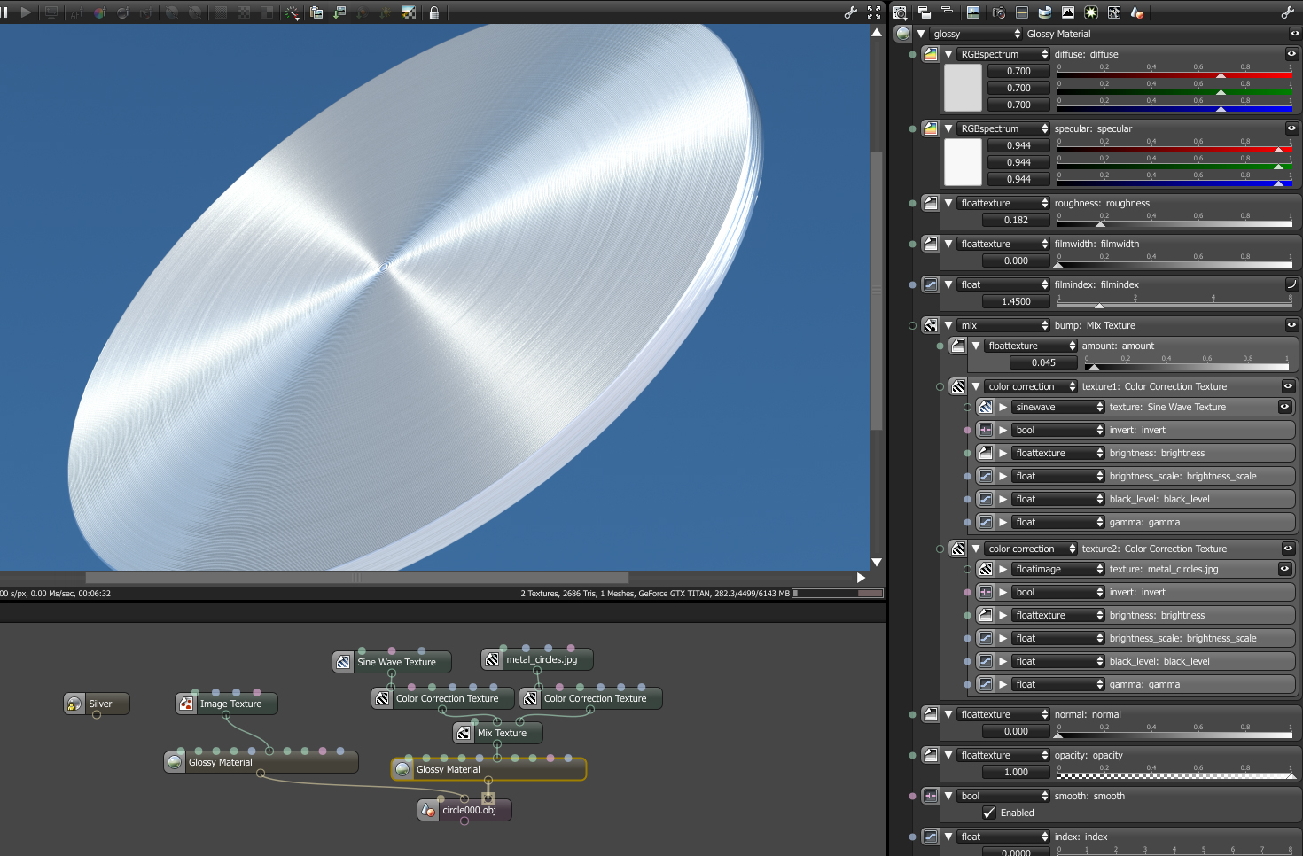

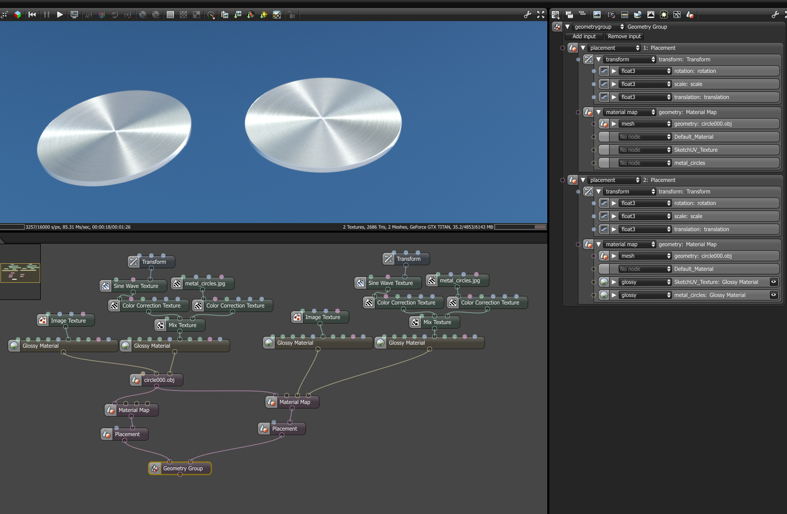

I managed to set two instances with translation node pinned into sine wave texture. The node graph editor has so many nodes just for two. But I need about 100
well done smicha, you can put all the materials nodes inside a mat-macro node
it would be nice to connect the placement of the obj with the trans of the mat for instant update
ciao beppe
ciao beppe
Thanks beppe.bepeg4d wrote:well done smicha, you can put all the materials nodes inside a mat-macro node
it would be nice to connect the placement of the obj with the trans of the mat for instant update![]()
ciao beppe
I tried to join translation nodes of the placement and texture nodes. There is one problem. They work in the opposite directions. +1 in x translation moves the object to the right, but texture to the left. So there is a need of multiplying translation value by -1 to connect them together. If OCTANE TEAM would be so kind and introduce math functions for joining different floats (values nodes) like multiplying by a constant that would be useful.
