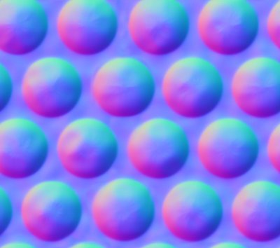

yes, this is in the 2.2 branch release notes,
you cannot use a bump and normal map at the same time.
if you do, the normal map will take priority and will be use solely.
The reason for this is that if we were to change it so you cand both, octane would become much much slower.
The benefit would outway the artist merging the bump map into the normal map and using the normal map alone.
You can convert bump maps to normal maps, google for tools, i even think blender does it, but i don't know how.

well both of them dont work for me too.. I tried bump and normal maps applied seperately..but they did not work individually also

I'm a Blender user, but I'm not sure that Blender can convert directly BUMP maps into Normal maps. It can bake a 3D model into a Normal map texture.
However, there is a simple trick to convert BUMP maps into Nor maps in Blender :
Create a highly subdivided plane and apply your Bump map as a Displacement texture for a Displacement modifier.
Then apply the modifier to make the displacement real.
Create a second object (a plane) and apply an UV texture to it, a material and create a new texture image on which you will bake the Normal map.
After that select the displaced mesh and the plane, and bake the Normal map using tangent parameter.
Save your Nor texture ! it is done.
For my own, I use CrazyBump pro : It is really fast, allows many settings and generate Specularity, Occlusion, Normal, and displacement maps in one operation !
