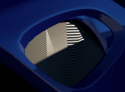

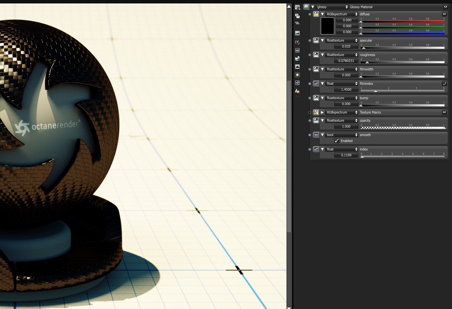

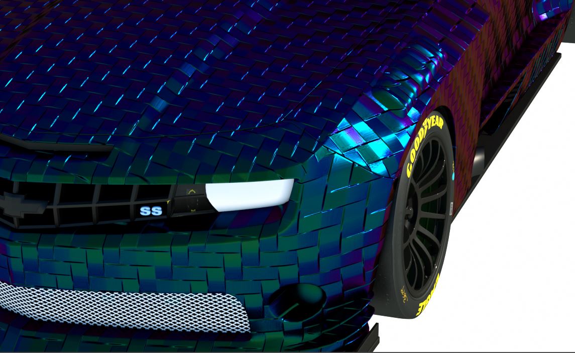

Been trying to find a slider to scale the carbon fiber in the LiveDB any pointers on how to get this looking correct on a model?
TIA
Asrock z77 extreme9 | Intel i7 3770K 3.5 | Win 7 64 bit | (1) EVGA Titan| 30" Apple Cinema Display | LEPA G1600W PSU | 16GB Ram | Storm Trooper Case |
Autodesk Inventor>3DS Max >Cinema 4D R14 Broadcast
face_off
Posts: 15814
Location: Adelaide, Australia
This either looks like the model is not correctly UV mapped, OR you need to turn on smoothing (and make sure there are normals), OR try changing your rayepsilon.

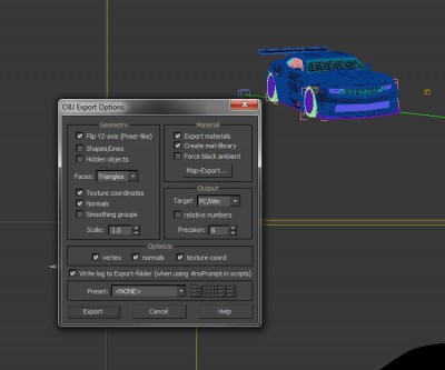

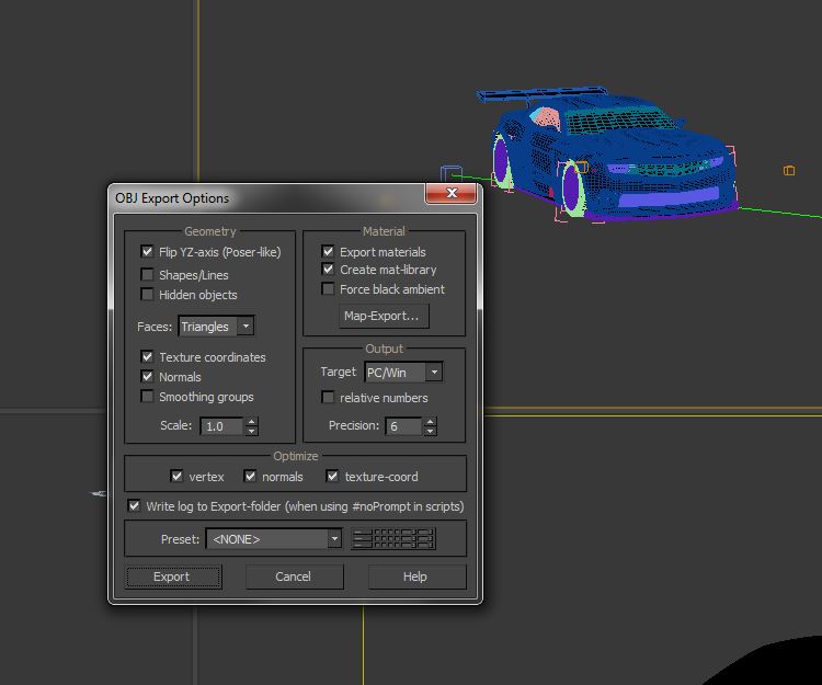

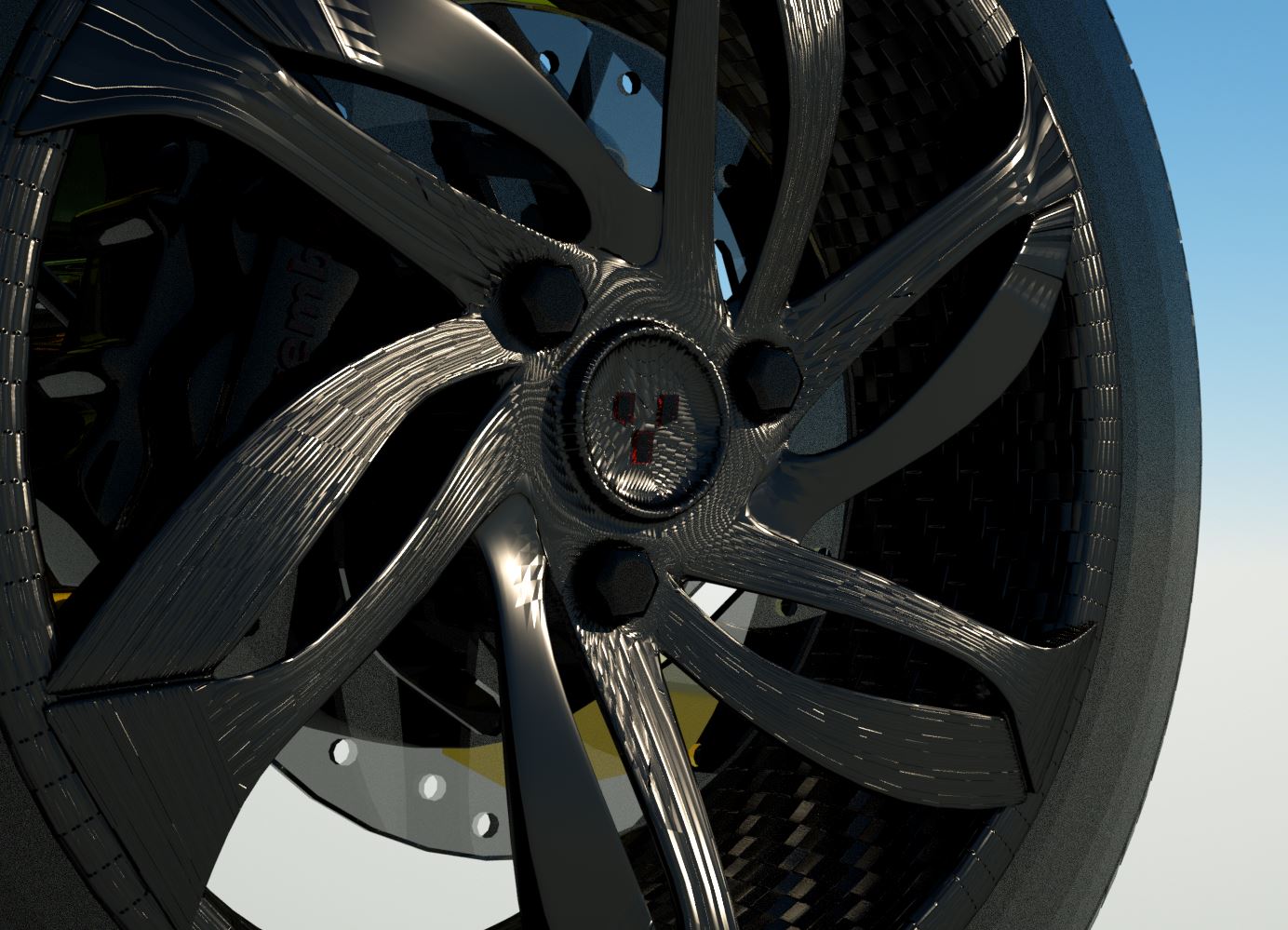

OK Using 3ds MAX as the exporter works better but I still see no way to scale the size down. Ray epsilon slider does not effect it.
Manual says
6.5 Render Looks Strange or Gives Unexpected Results
Problem: Concentric circles over the image or unusual effects
including bump map not working
Solution: Check the scale of the imported scene and change the
rayepsilon value. Typically this is due to the scale being
incorrect by a factor of 100 or 1000X. Octane expects 1
unit in the scene to equal 1 meter. Adjust export settings
in the modeling application or adjust the import settings.
in OctaneRender™.
My Max export settings seem correct but how would I know what scale the 3ds model is before exporting?

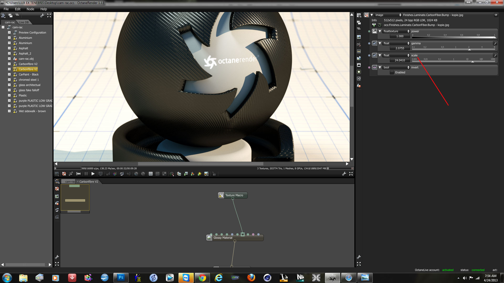

Have you tried adjusting the scale slider on the texturemaps in the carbon fiber material?
buzby
Posts: 187
Joined: Wed Dec 05, 2012 4:02 pm
face_off wrote:Have you tried adjusting the scale slider on the texturemaps in the carbon fiber material?
I am sure I am doing it wrong, I chose the carbon fiber with the object picker but I dont see a scale slider. Where would i find the scale slider on the texturemaps in the carbon fiber material?
face_off
Posts: 15814

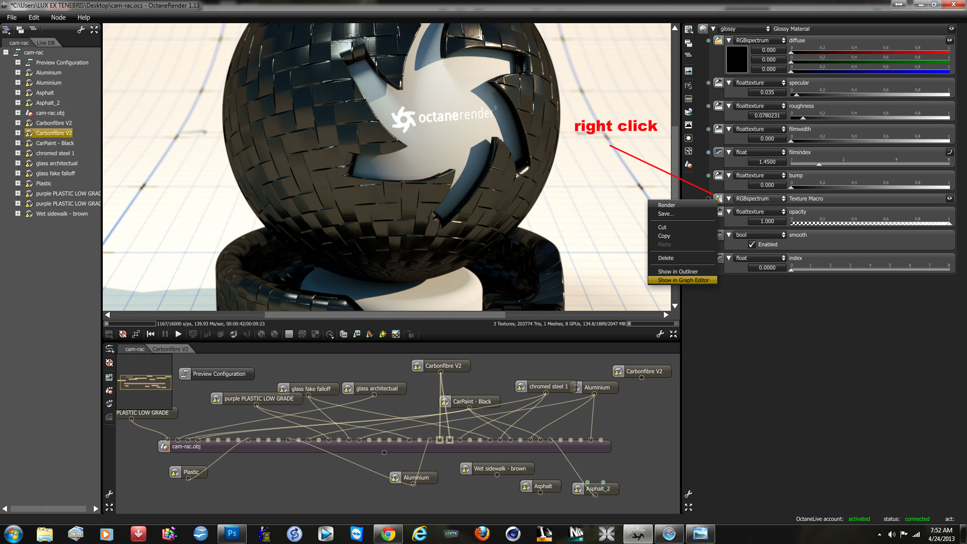

It is inside "Texture Macro" - which is the normal map.

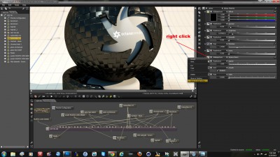

face_off wrote:It is inside "Texture Macro" - which is the normal map.
Took a little doing but figured it out. Apparently the scaling requires a right click on the Texture Macro which allows you to "edit in graph editor" that did the trick, thanks all

Also you should be able to double click the texture macro that is attached to the normal input and this should open up just like the material macro did, exposing the composition of the macro.
Chris.

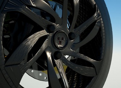

Thank you Chris. One more, Is there a simple way to wrap an object with carbon the fiber material correctly in LiveDB? I have tried the scaling but in this instance it does not make a difference.
FooZe
Posts: 1335
Joined: Tue May 15, 2012 9:00 pm
Hi Buzby,
No, the UV's will need to be mapped correctly in your 3d modeler.
