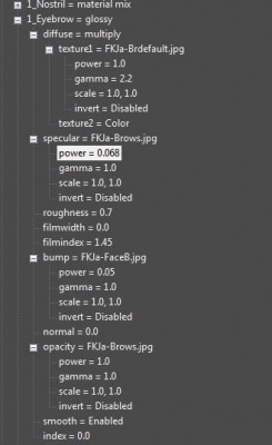

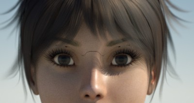

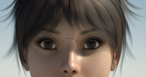

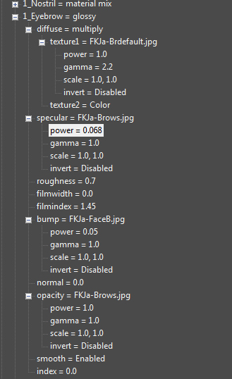

I have attached a screenshot of the artefact and of the default material settings imported from Poser. The FKJa-BrDefault.jpg file is simply an RGB map of the eyebrows area, the FKJa-Brows.jpg file is an alpha map (eyebrows in white, rest in black) used as a transparency map. I could, of course, simply merge the eyebrows with the face map in Photoshop, but I am intrigued to know why the artefact occurs.

Ah yes, I've seen that before. Octane will not handle a transparent material where the geometry (vertices) match exactly the position of other geometry. Where you see that black line is where that eyebrow prop meets the figurer's head. Either pull the brows out a fraction, turn rayepsilon to 0, or even scale up your scene in Poser by 10 or 100. A similar issue can happen when and eyelens cover exactly matches the geometry of the eyewhite.
