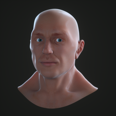

Hi, everybody.
I try to make SSS here on this tutorial, I do in accuracy everything as shown:
http://www.youtube.com/watch?v=6a4fwNYB ... B&index=23
Here is my results:
https://www.dropbox.com/s/vb1223qimkz0jvz/sss.jpg
If it is honest, the result not to be pleasant to me, it is impossible to achieve more or less natural look
You couldn't explain to me that I not so do?

face_off
Posts: 15761
Location: Adelaide, Australia
Looks good. The overall look is a little waxy, but reducing the scale will fix that.

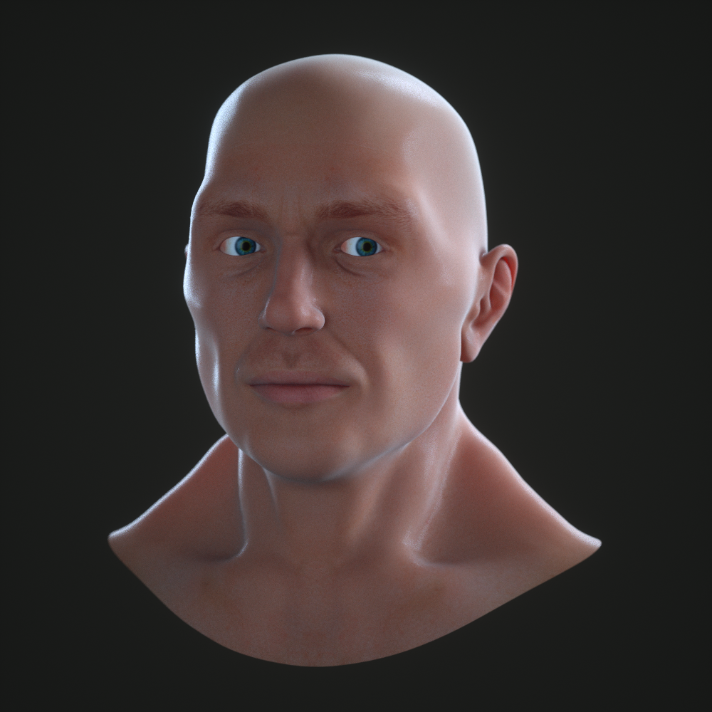

Here is a new result with making SSS skin
Win 8.1/64 | Geforce GTX780TI | Core I7 970 | 24GB
xxdanbrowne
Posts: 503
Joined: Wed Feb 06, 2013 2:38 am
Very nice work!
