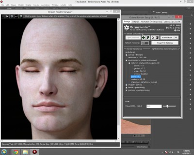

Hi - can you post a screenshot of your Settings tab in the plugin, with the "environment" pin expanded?
What is the full path name of the HDR image that you are using?

Thanks Paul. The path name of my HDRIs contained special characters (Icelandic) so I moved the folder to the root of my drive and that seems to have done the trick :) Does the plugin have problems with special character? Should I move my Poser scenes to another folder?
