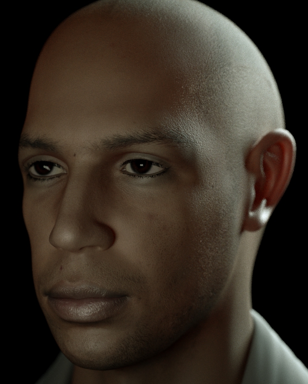

Been working to get a good skin shader. Attached is my latest attempt. Been also reading the manuals and watching video tutorials, however I'm confused.
Can someone explain to me the fucntions and connections between.
-Transmission
-Absorption
-Scattering
-Scale
I thought I had it sussed, but can't seem to get it to work the way I think it should. My initial view was the following, but sometimes it doesn't seem to work this way.
- Transmission - assign a colour or texture that the sss will show
- Absorption - the amount that light is absorbed, therefore 0 is no absorption and 1 is total (ie effect will not show at all)
- Scattering - not really sure what this means
- Scale - seems to be 'tweak' to get the right effect
As I said, if anyone can explain these things in a way that actaully makes sese, that'd be great.

Anyone? Or anyone point me in the direction of an explanation that means something? Manual doesn't really tell me anything

FooZe: an excellent explanation. Thank you an immense amount.
I don't understand it all
But it wil allow me to explore the effect with a lot more intelligence than I had on the subject.
