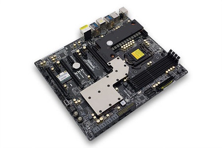

great choise! lookin' forward to see Your build! =)BKEicholtz wrote:I just went through this research process. I chose to go with the ASRock x79 Extreme11 motherboard. I am just finishing my build. As mentioned in various hardware forums, the chipset fan is a screamer. I am going to full water cooling, which is -by the way - awesome with the Titans.
The Extreme 11 is unique by the way they designed the board for extra PCIE lanes for multiple cards.
I hope this helps.
Best,
Brian
p.s. might be interesting for You: EK Water Blocks Intros ASRock Z77 Extreme11 Water Block http://www.tomshardware.com/news/Water- ... 21987.html

I just may share my rig photos when I am done.. The z77 board is considerably less of a board than the x79 board. (I am pretty sure you know that, but I just wanted to mention it for clarity of other readers.)
Thanks!
Brian
