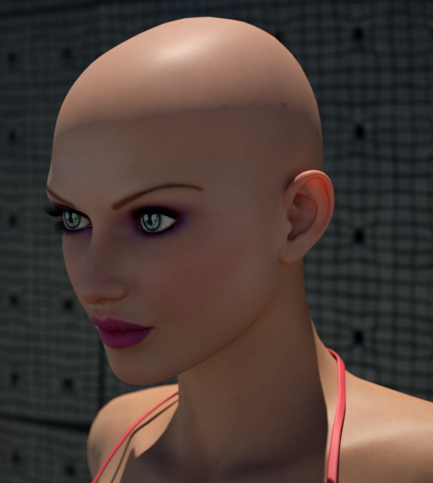

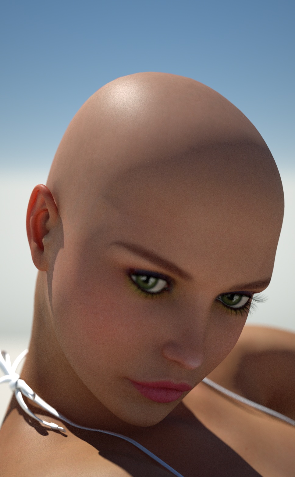

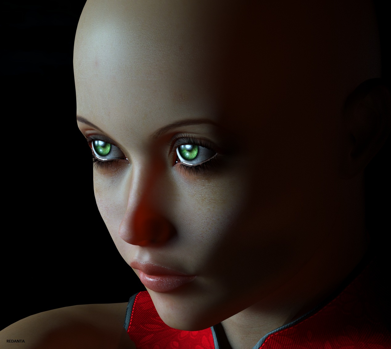

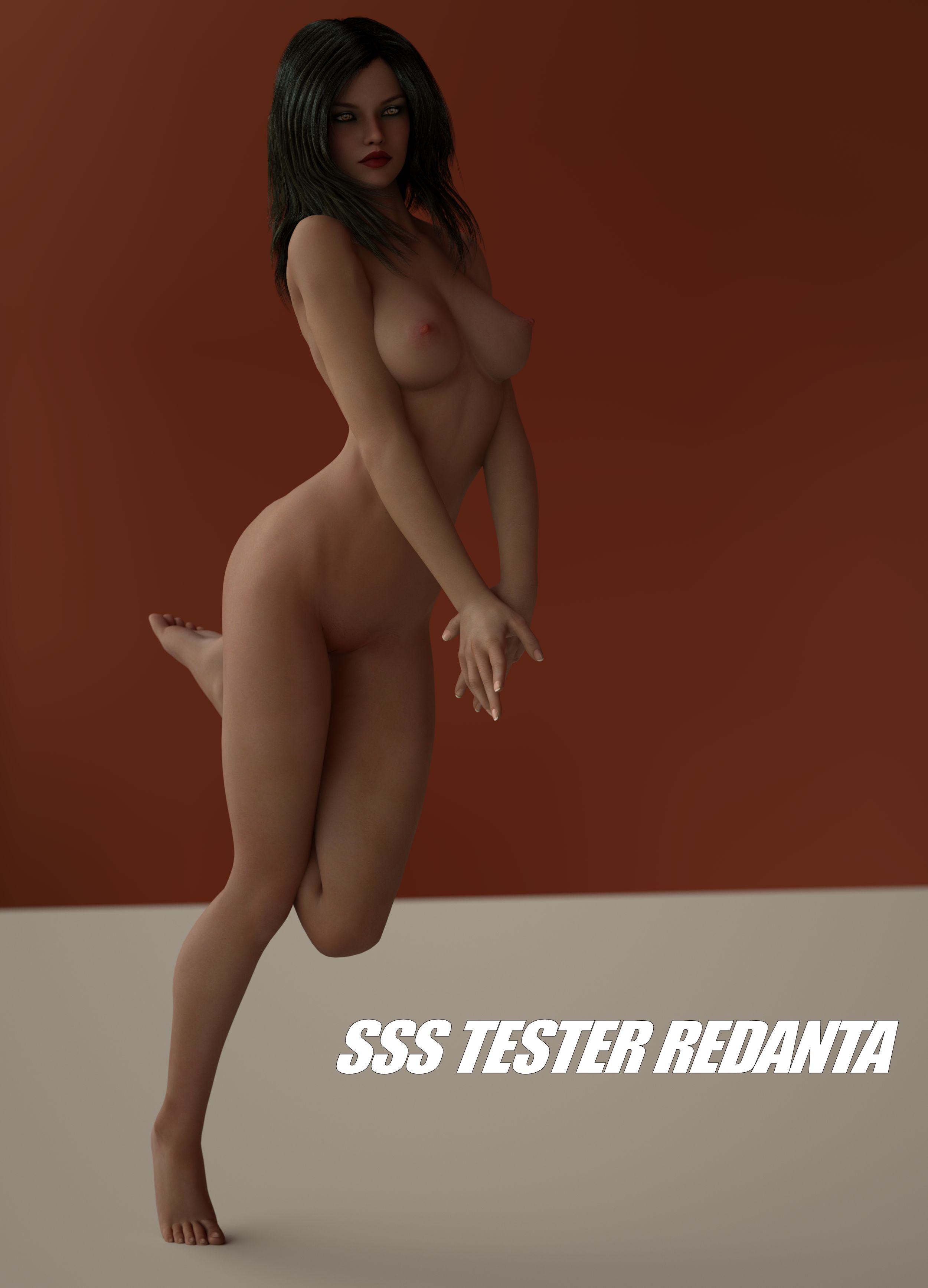

For all you Noobies :) All this sss skin material presets and so on ... Ive been at work with it for quite a few months now.. Ive uploaded pics to show my node structure, but to save you all the trouble I will share my complete body .POC files that you just import to V4 and from there you can fine tune to your liking. I use Drop Box https://www.dropbox.com/sh/ry8qa0c79aylsld/LpUplu5e93 :) :) :)
Excuse the nakedness, I asume we are all adults here, Paul please let me know If I should remove it, Its to show the skin effect
