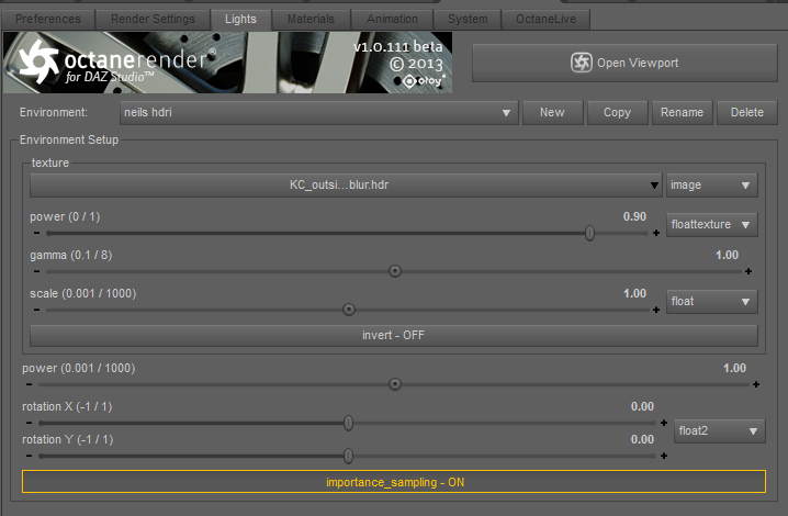

Ok, so i chose `copy` gave it a name, rebooted DS and the setting was still available to me once I reloaded my sceneEvery time I open a scene where I've painstakingly set up a daylight environment (correct location, time, offset etc.) it defaults back to the basic one?

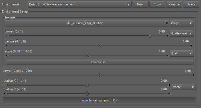

Have you tried loading a different enviroment map?.. See image below, is that what you mean?and while I'm here.... is there any way to render over a bg image in the viewport?

- Under preferences..
Maybe this will `hide` your objects? - Capture2.PNG (2.35 KiB) Viewed 5296 times

Right, back after some testing.... orion_uk, I tried your copy environment technique and its partly working
What's weird is that say I create a scene, twiddle with the default..... oh... hang on... I get it now
Never mind, you're right, copying seems to work fine
