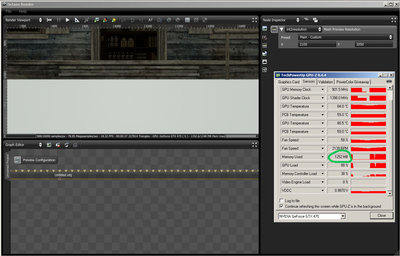

Thanks radiance, that will be very useful!
I was searching the net for Vram monitoring and found GPU-Z.
http://www.techpowerup.com/downloads/SysInfo/GPU-Z/
A very useful tool for me right now. Didn't know that Vue used 540MB on that scene I used
No wonder Octane crashed. Poser on the other hand only used 240MB, but I can adjust the texture sizes to 128 in the preview, so I can get it as low as 80MB leaving me with 1200MB of fun in Octane
This has really helped me with what I can load and what I can not load in Octane.
