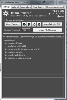

Downloaded, I thought, the 1.11u-4 release from the post in the first post of this thread.
Installed and started octane... but... it reads (1.11u-3)
Hard to find new releases around here

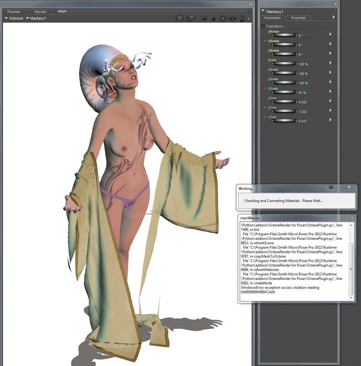

Oh and the error occurs at the same line number 7490.
Log files attached..

1.11u-3 is actually the correct version. 11u-4 is my latest development version that I have not released yet - sorry - my fault.
The actual failure is occurring after creating an octane node and then applying that change to the scene in the video card. I am 90% sure it's a hardware issue - since I have never had an issue of an exception doing that operation before. Looks like it's occurred when setting the sun vector into the Octane sun direction (so the scene has loaded into the card, then Poser updates the sun vector and the scene on the card appears to have corrupted). Is that scene using the daylight model, or an IBL texturemap? Can you tell me if the error occurs swapping to the other (ie. if IBL, then does the error occur when using daylight lighting?). What about if you use a different IBL textruremap? What about if you turn off Importance Sampling?
Are you using 1 video card for Octane rendering and as your Windows display adapter, or do you have a second card or on-board graphics for your Windows display adapter?

Ran the VMT test... all clear on all fronts.
Only one video card... but nothing else loaded except... AutoCAD 2014, Photoshop CS6 and CorelDraw... just joking... nothing else loaded, not even Explorer.
Daylight and Environment cause the same failure and with different IBL and HDR image maps.
I guess I'll just have to settle for changing some of the props as I did to get the render to work.

If possible, I'd love to get a copy of a scene that causes the exception. It might just be one small prop that has something amiss with it which I can fix for you. On a scene which raises the exception - what does clicking Image File Statistics give?
