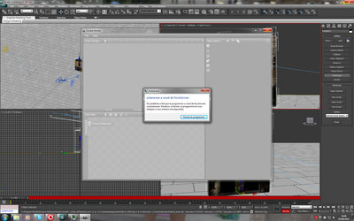

using maxtooctane octane freezes on export every time ..
??what to do ??
??what to do ??
portable clevo 900f/i7920/6gb/nvidiagtx280M/win7 beta 1.022b
Did you remember to collapse the modifier stack for your objects?
