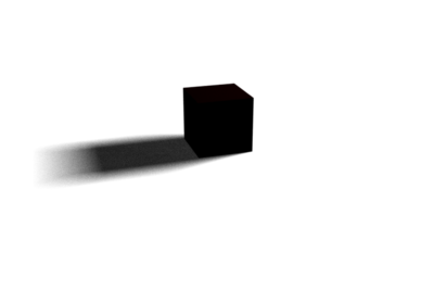

BTW rendering with No Environment produced this

ericg wrote:BTW rendering with No Environment produced this
Isnt that because your light source is only hitting one side of the cube....
