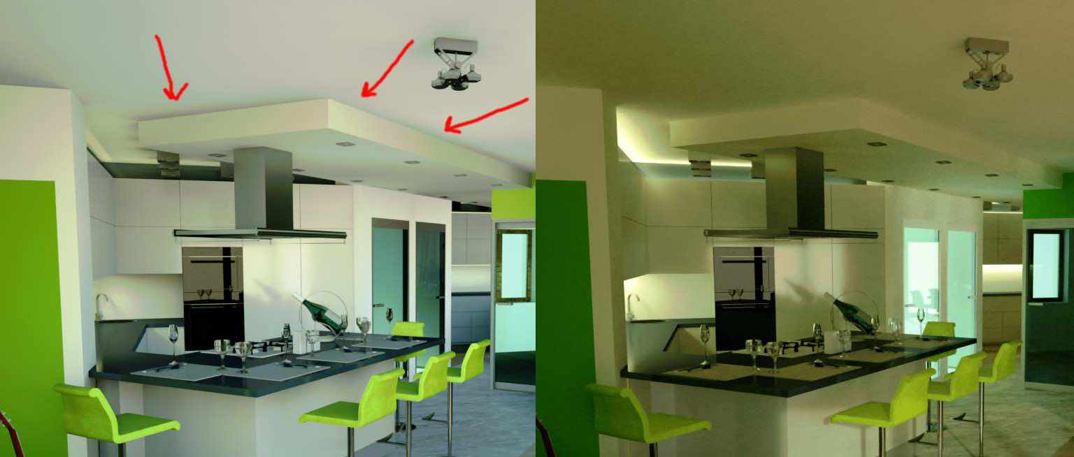

- I made few test renderings with heavy polygon interior scene, and although all results are very good, it seems that sometimes shadows on the ceilling doesn't look right with direct lighting ( like some parts are not connected ). Is it due to limitations of direct light kernel?

direct lighting vs pmc
This appears to be the rayepsilon setting OR an AODist. Did you try adjusting these to fill the gaps? You can also scale the whole ArchiCAD scene (in the Configuration). The recommended scale is 1, but slightly smaller settings might help (I have not had time yet to conclusively determine it this is beneficial or not).

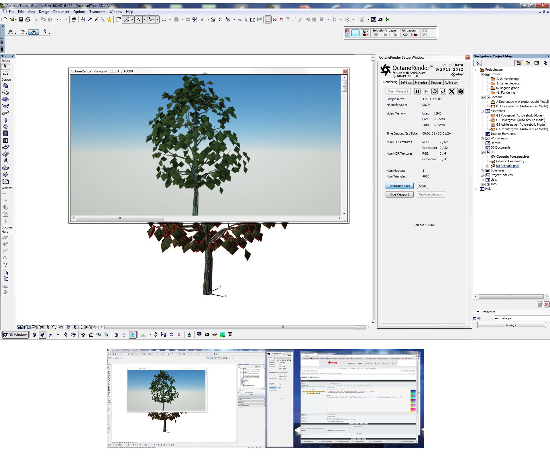

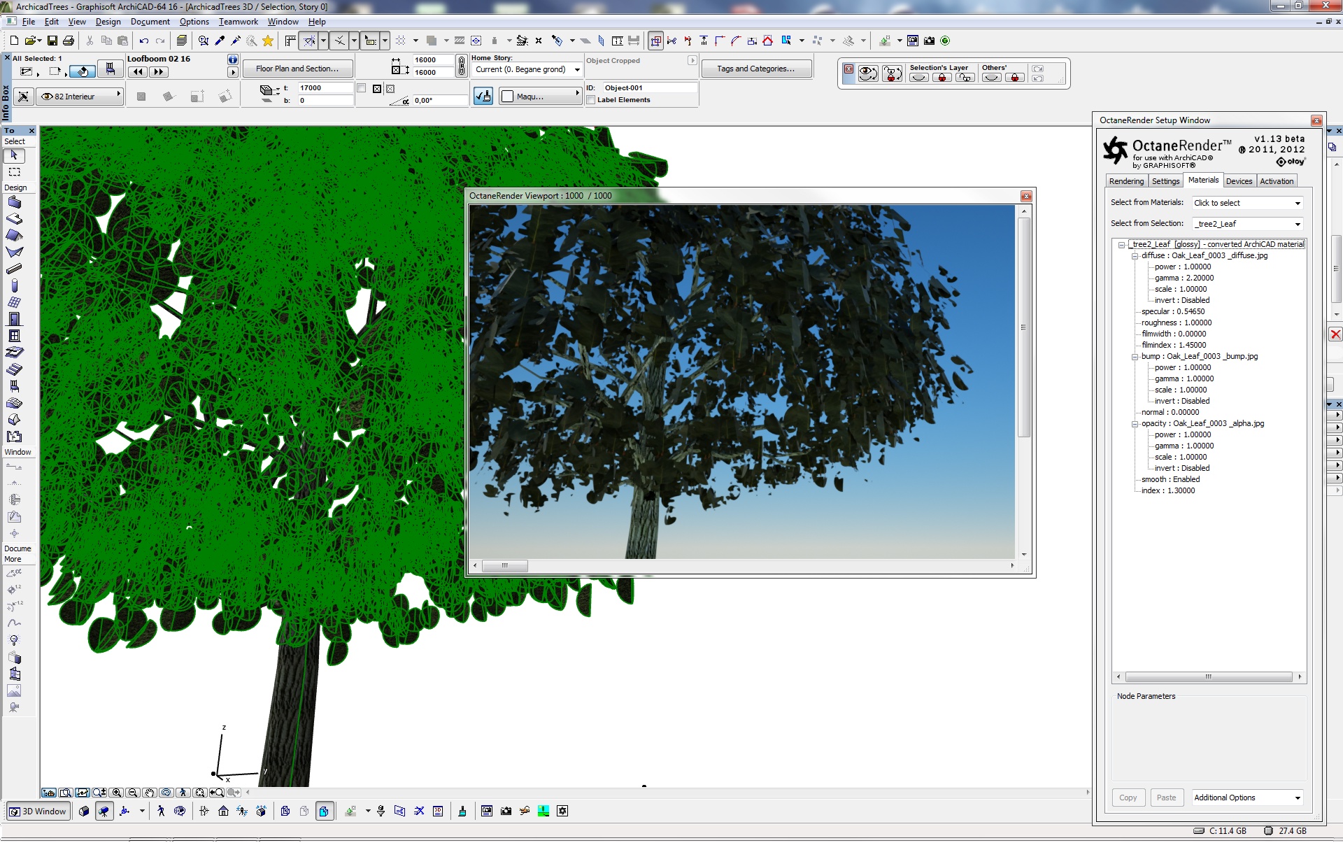

As you can see in the image I started a testscene with a standard tree form Archicad.
I will add a new post with some material experiments with this tree.
@face_off,
I am working with two screens and I put the OR Setup Window on my second monitor on the left side; nearby as you can see in the small printscreen below of the image.
For me it is no problem the OR Setup Window is floating as a seperate window form Archicad.
But when I have one screen it would be nice to lock the OR Setup Window like another Archicad Palet,
because when it is floating on the Archicad Window it sometimes is not handy
and I have to move the OR Setup Window around the whole time.

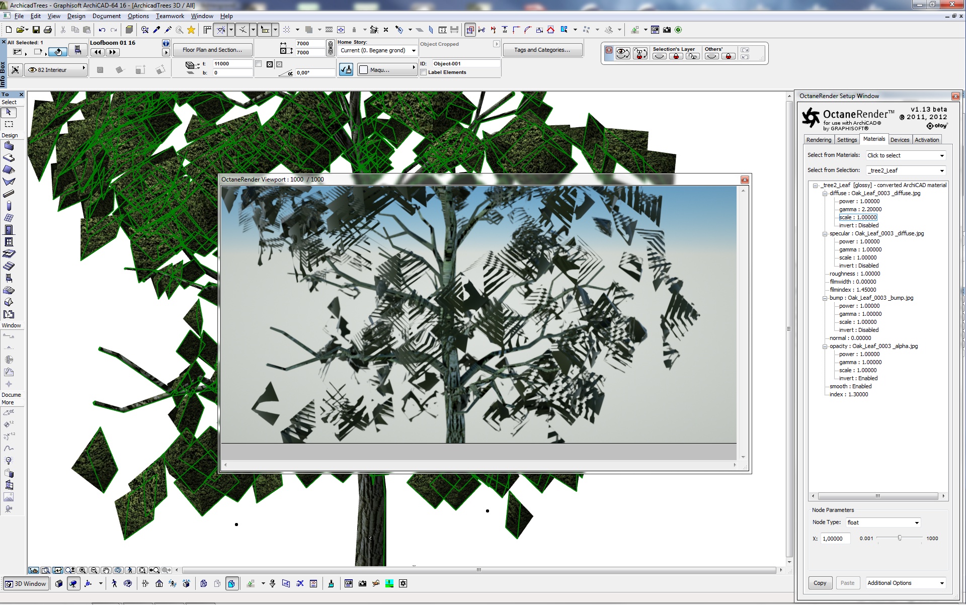

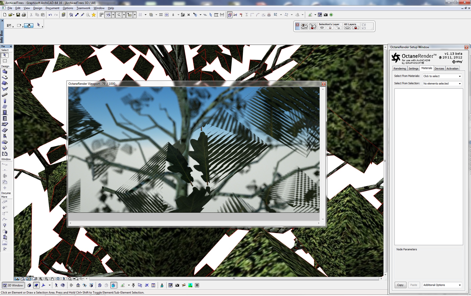

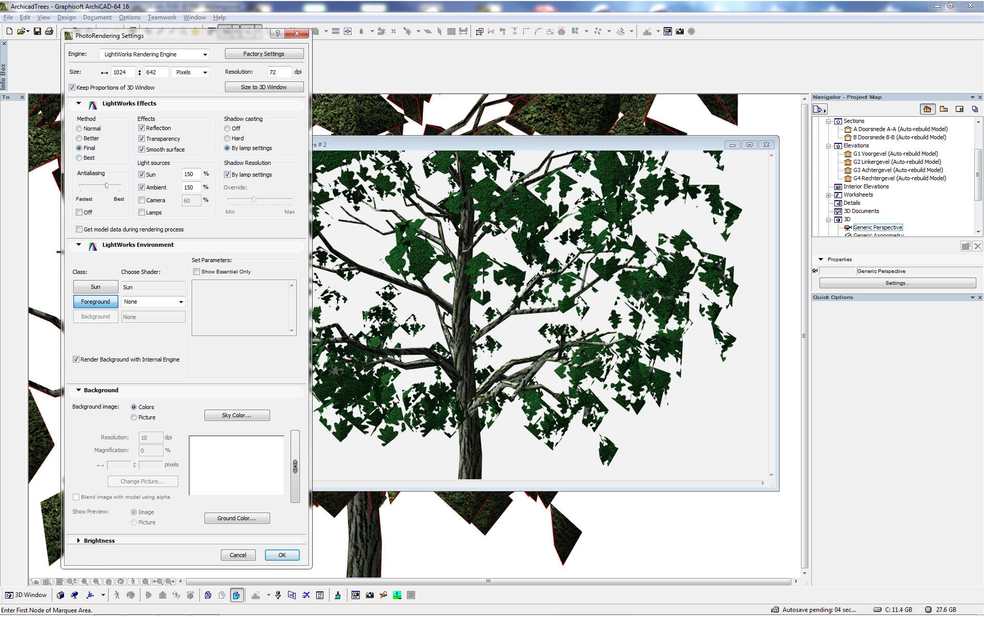

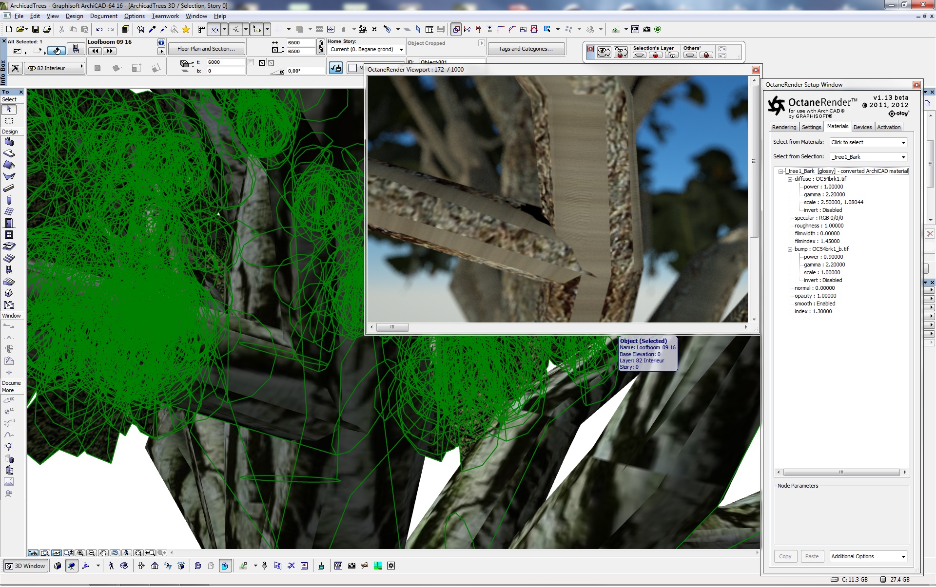

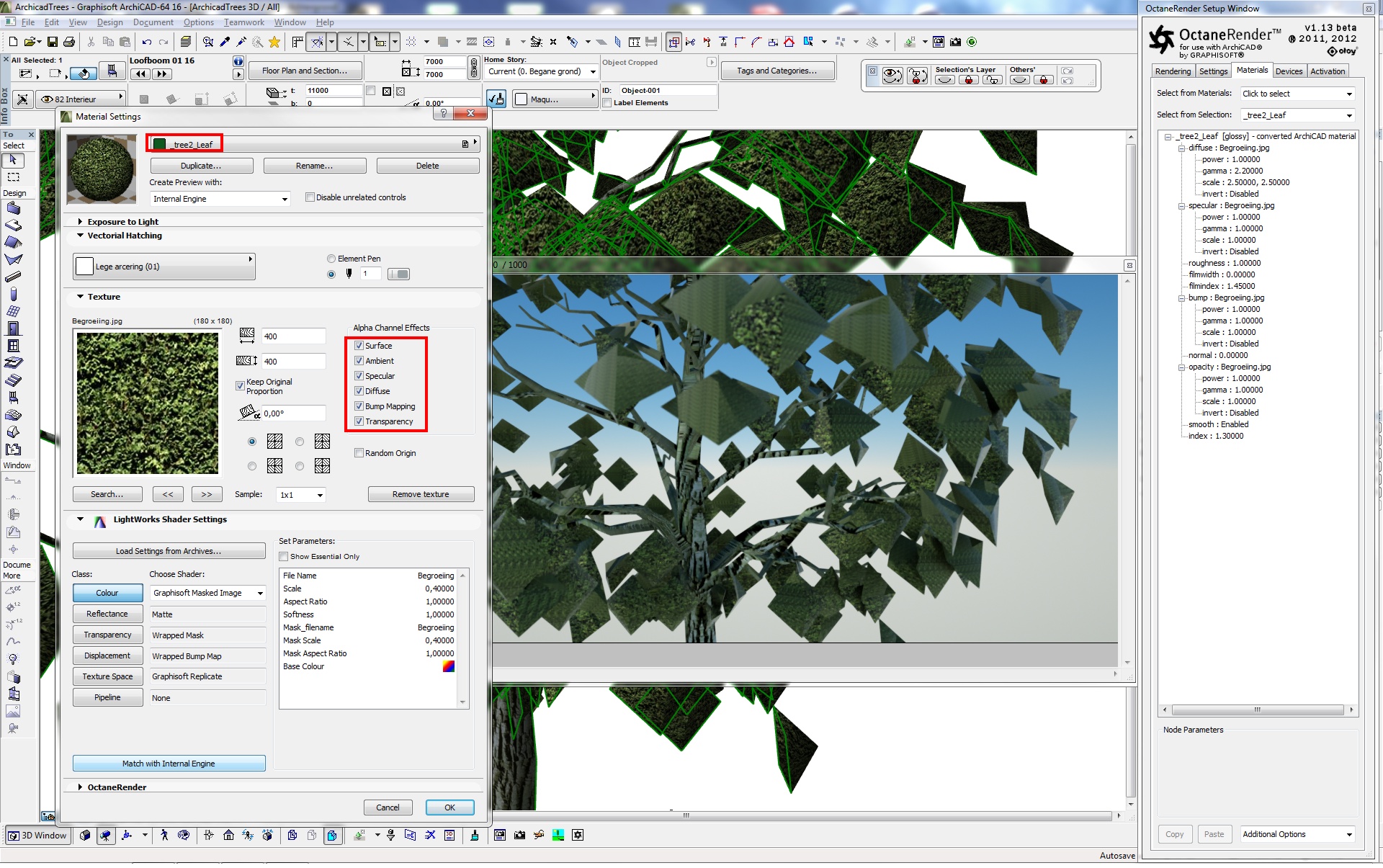

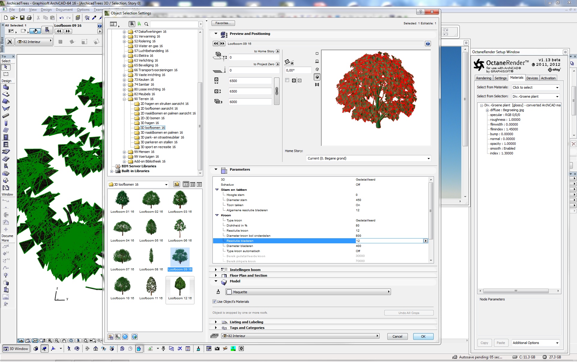

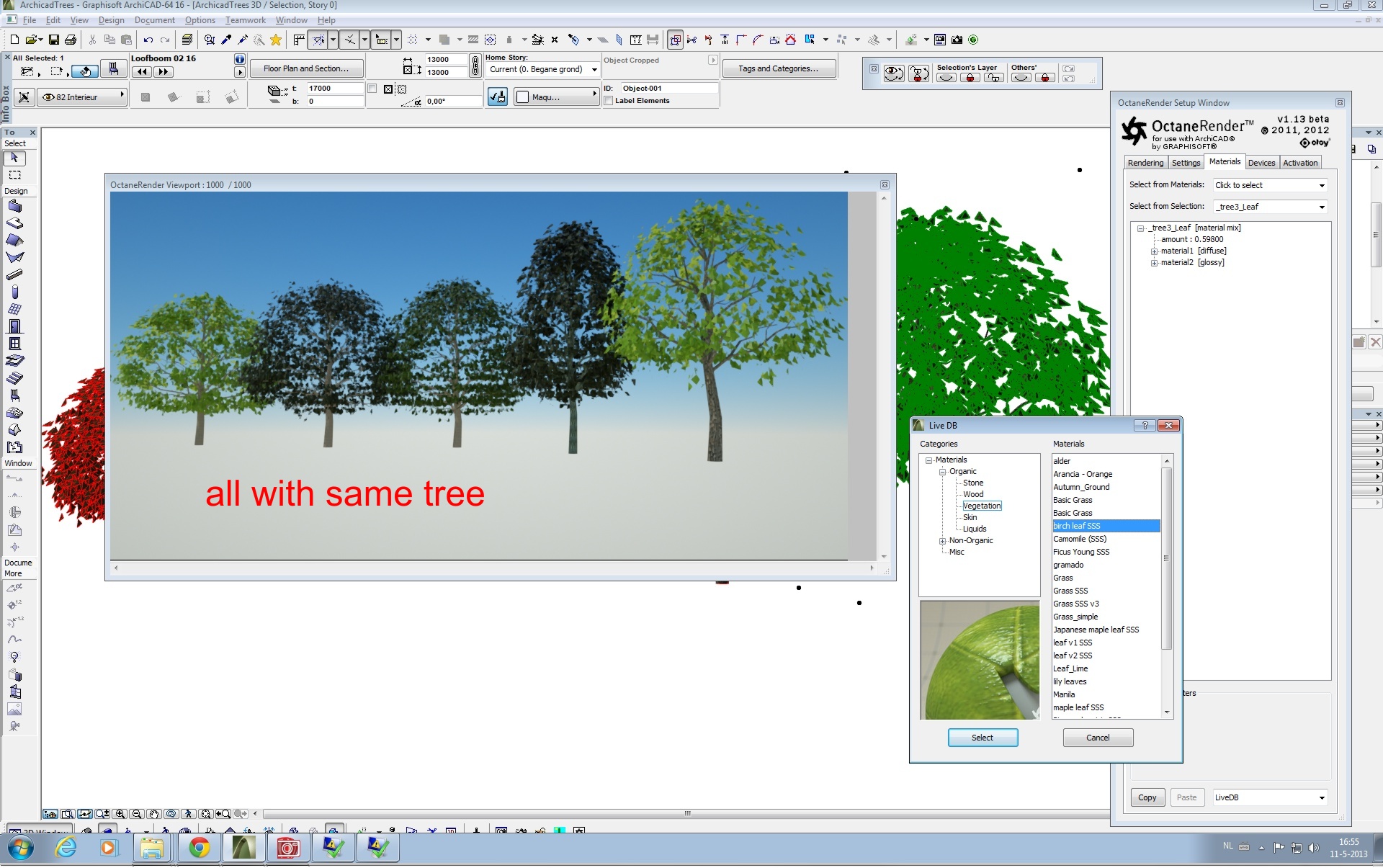

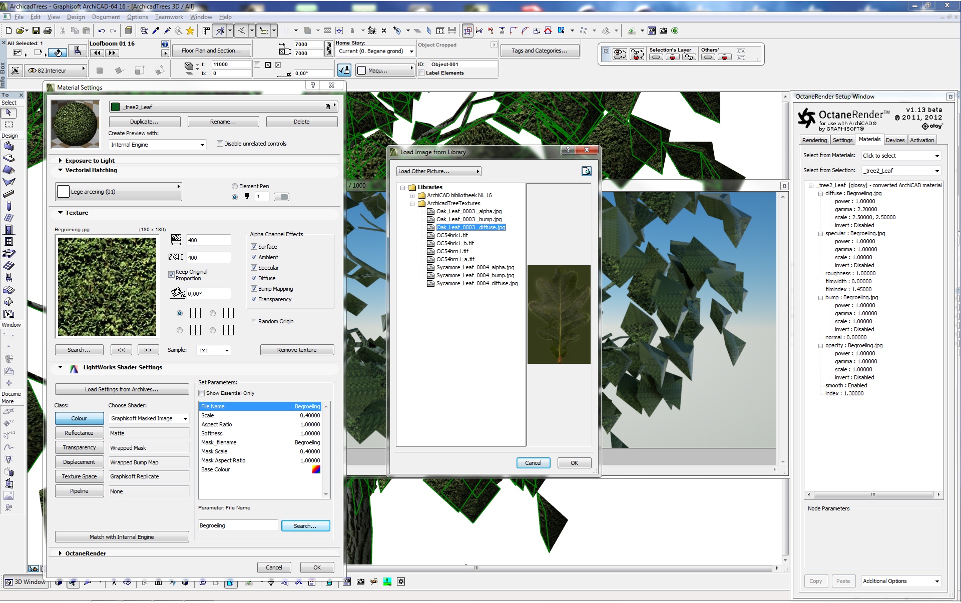

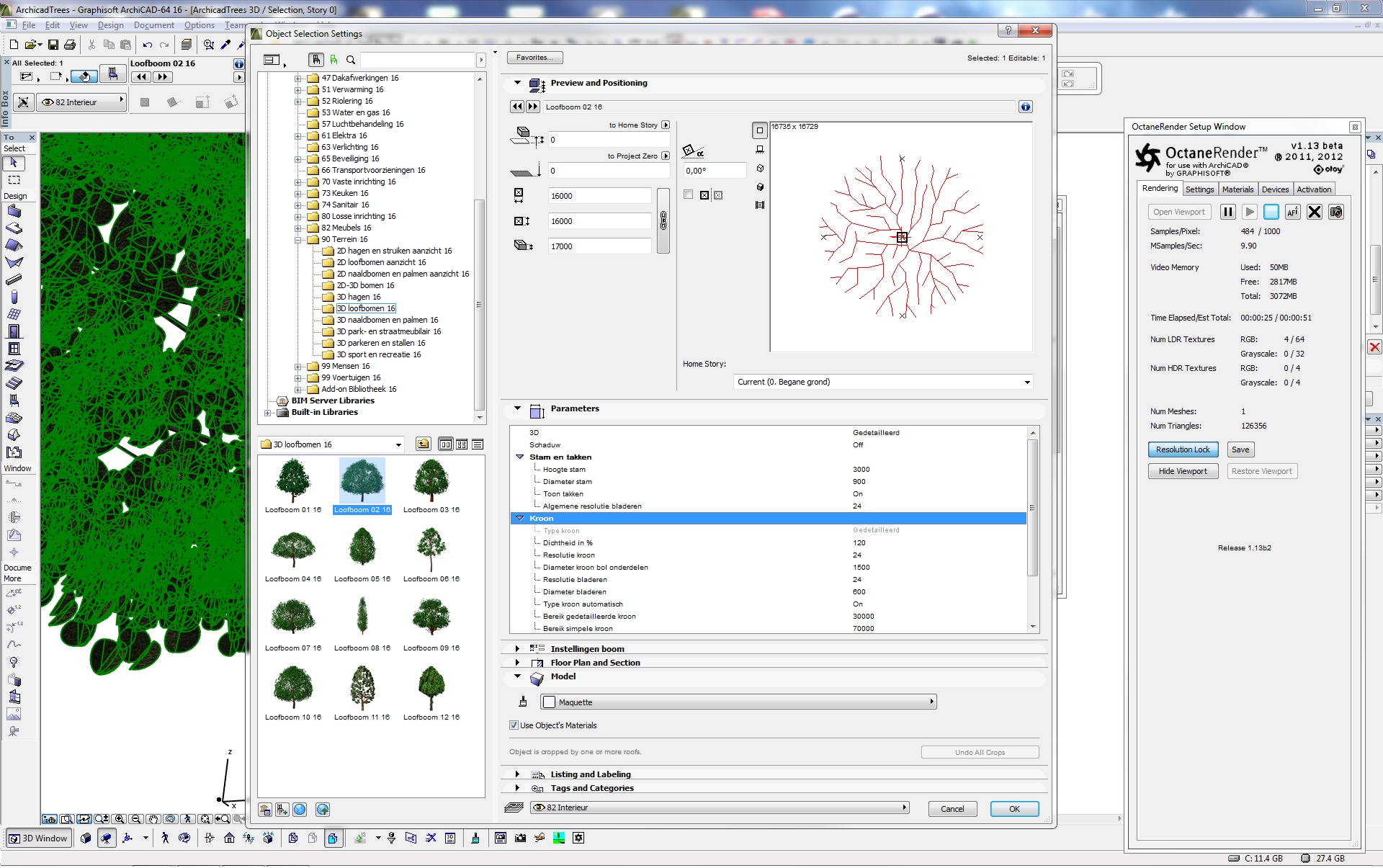

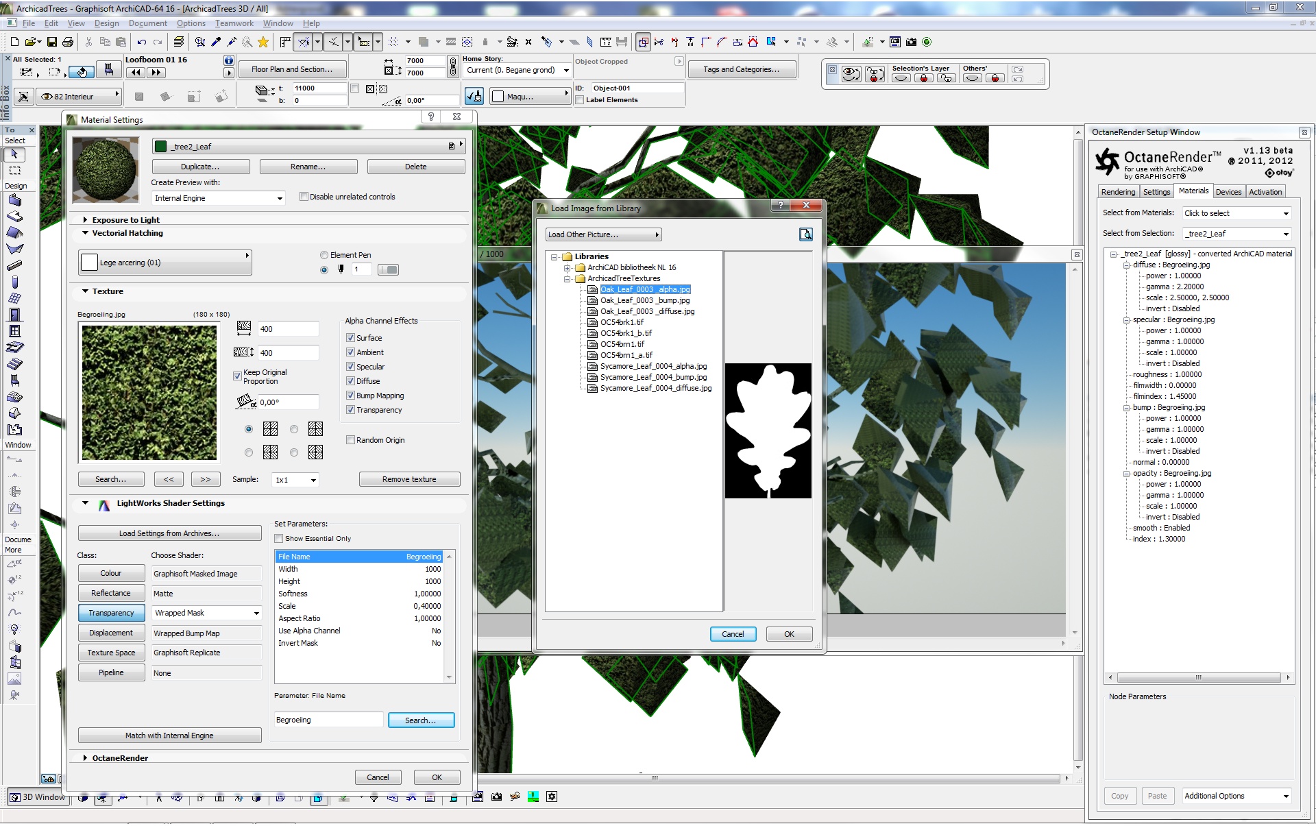

Hi guys,
Until we can link OBJ trees I just use the standard tree objects from Archicad and tweak them.
You can use just one tree object to make different trees by adding different materials to each tree and tweak the material in the plug-in with you own textures or form DB. The hard thing for the first time is to find the right scale.
Not all trees are optimal for doing this.. some Archicad trees have leaves with more faces in different directions, but I found out the UV mapping is pretty awkward when trying to apply a texture.
I hope the printscreens make sense without further explanation?
ArchicadTree1_12.jpg shows you different trees using just one Archicad tree with different settings.
It is not really good form up close, but in most scenes it works for environment. You have to be careful to use them while in certain viewpoints you can see the repetition. Using the material from DB seems to work better to disguise that.
But hey, in a few months we will be able to link to our own high quality OBJ trees.
But if you don't have such a library you can do it this way.
You can a result (renderings and animation) with trees done like this: http://render.otoy.com/forum/viewtopic.php?f=5&t=31907
Greetings, Jeroen (rappet)

Jeroen - TY for the tree tutorial - great explanation.
I do not believe it is possible with the current ArchiCAD API to add a window as an ArchiCAD palette. The actual Octane plugin windows are of type "Palette", but to ArchiCAD this means they are always on top. There is no way to integrate then into the ArchiCAD main window. It would be great if I could add a minimize button to the Setup window - however doing so puts it under all the other windows and you cannot find it again. Maybe a "rollup" button could be possible. - I will add it to the list.
