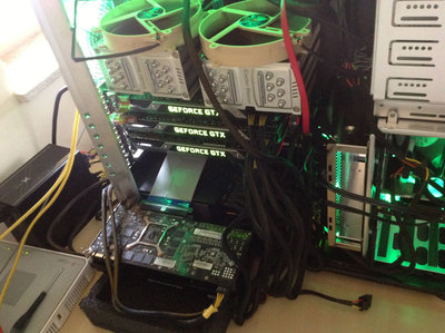

I have the same board you want to buy, this is how it looks like:

Apparently there is a problem if you have more then 5 GPUs in the system. Beware, one GTX690 counts as 2 GPUs. If you have more then 5 then there is a problem with OpenGL. For instance photoshop can't use GPU acceleration and in 3D software viewports some things start working very slow. So you should definitely go for TITANs becaue 1 TITAN is 1 GPU at the speed of GTX690.
One GTX680 is connected using PCI extension cable. It renders fine but OpenGL has problems because this is 6th GPU. There is a way to overcome this. I connected two GTX690 via SLI, this tricks drivers in some way that you have less GPUs because you paired them and OpenGL works fine then at the expense of having less GPU RAM because SLI is active.
Here is my system:
Intel E5-2687W
Asus Z9PE-D8 WS
G Skill F3-12800CL10 4x8GB
2 X Intel SSD 520 240GB
Cooler Master TPC 800 Vapor Chamber
Noctua fans
Silverstone TJ10
GPUs top to bottom:
GTX690
GTX690
TITAN
GTX680
