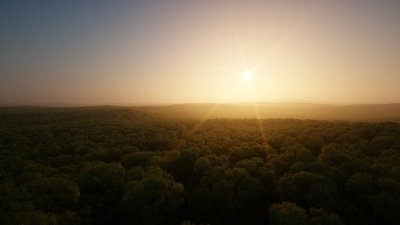

How to use fog
3dsmax 2012 scene

Sorry, I don't understand how the sphere around the camera works. Everything goes out of focus when I put it in a bigger scene and the focus picker doesn't seem to solve the problem. What am I doing wrong exactly? The fog 'box' works fine in any scene though, I just don't get the rays which I presume the sphere around the camera makes.
@suvakas - thanks for the tip - didn't think about that approach - can this be saved in the octane liveDB - I got used to using it as well - preset HDRIs
@princedragoncok - did you try reducing the aperture settings to zero - if it still goes out of focus - then your scene scale is too low - check units setup and try importing from a bigger scene to the octanefog file to test out scaling issues
