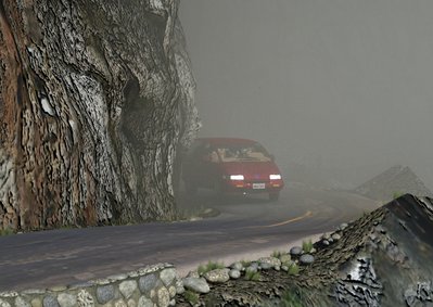

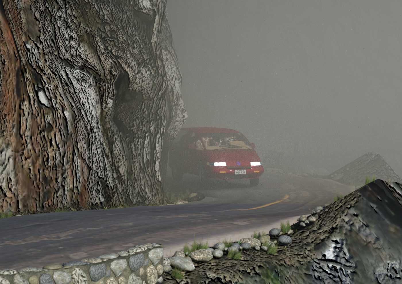

Fog turned out to be pretty easy
Load a box, set it to specular. Now turn off reflection, set medium to scattering.
Next part depends on how thick you want the fog.
Increase the scattering power a bit (not too much)
Lower the scale to taste
In the attached picture I used a gradient to control the fog thickness. Main reason is that I wanted the transition between clear and fog to be smoother
The gradient is from white (top) to black (bottom). Scale 1. Then I set the scattering scale to 0.25.
In the picture I used daylight and set the tubidity to 3.2 to lower the light intensity a bit.
1.11 fog applied to box

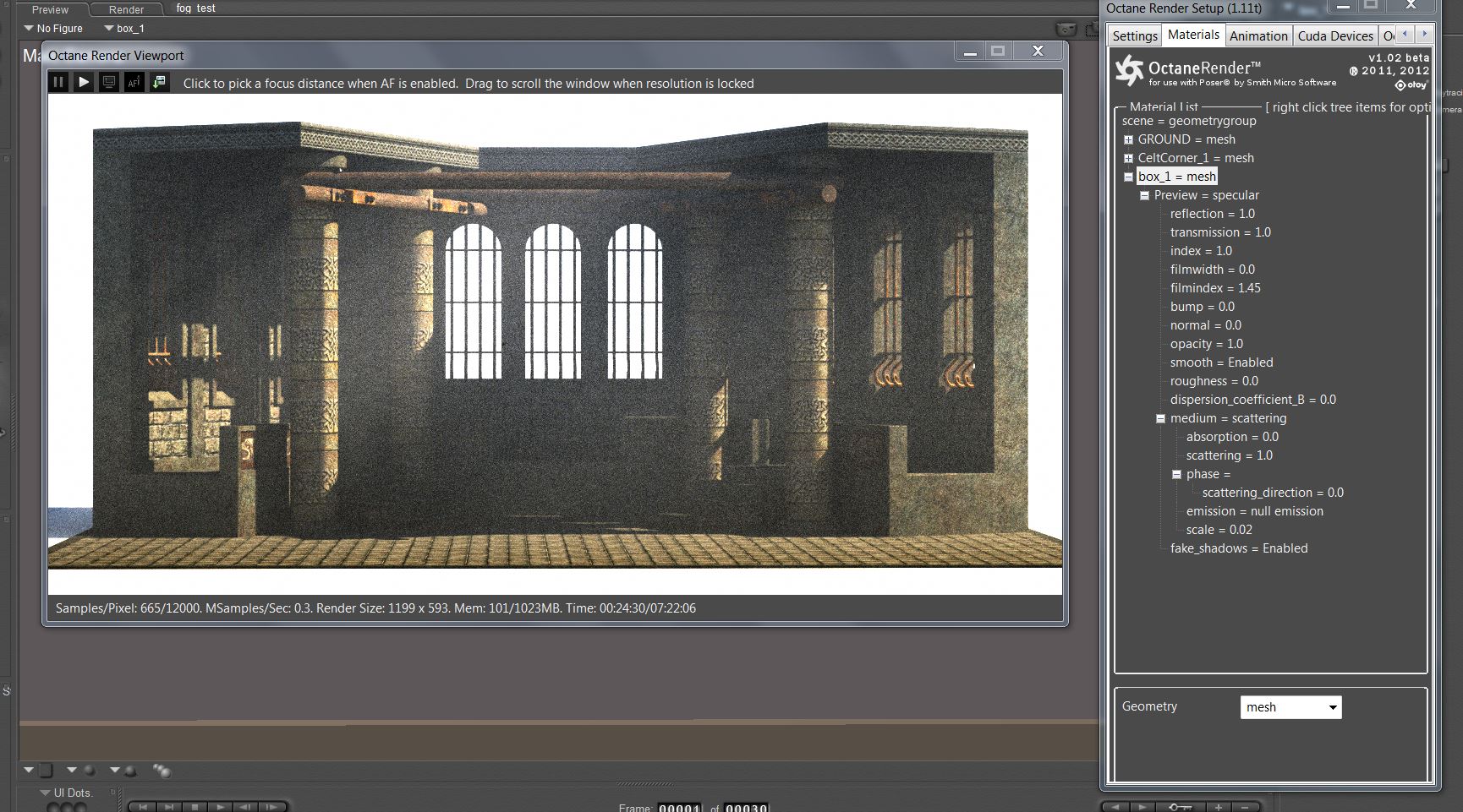

Basically, what wimvdb said, except that I found it to work best with reflection 1 and scattering 1, adjusting scale to taste.
I posted a screenshot of my settings for volumetric shadows. Important pathtracer settings were maxdepth 16 and caustic blur 1. Environment is daylight, turbidity 2. This makes the fake shadows more pronounced. For the screenshot image, I also increased exposure and lowered gamma to increase contrast.
The camera must be outside of the box prop that has the specular material.
Win 10 Home x64 / NVIDIA GeForce GTX 1070 8 GB / (Intel i7 2.8 GHz) x8, 16 GB RAM / PoserPro 11.2

Awesome - thank you! Looks easy.
Camera needs to be OUTSIDE the box.
Very very small scattering/small figures seem to works best. And absorption at 0 gave me the best result. Index = 0 and camera->aperture=0.1 helped too.
