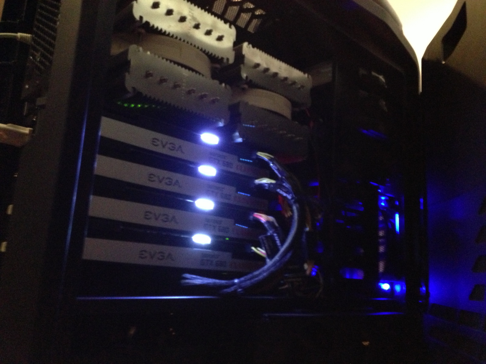

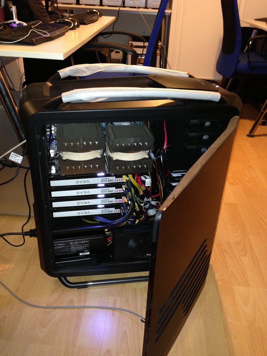

Now it's filled with 4 GTX680s but I've ordered 4 Titans yet
Specs:
PSU Silverstone Strider 1500W
Processor 2X Xeons E5-2660 2.20GHZ 8C-16T
Raid 1 boot 2 X Intel SSD 120GB
Raid 0 data 2 X Intel SSD 240GB
Ram 32GB ECC Kingston ddr3 1600
Motherboard Asus Z9-PE D8 WS
Pro:
monstrous super silent case, it's huge! (well designed)
680 power consumption is less than the 580 systems
Maximum temperature measured: 74° (it's a sandwich config, only one fan on the back) (on GTX580 systems I previous measured 85°)
monstrous power with V-Ray and Live
very good power with Octane (sometime better than my other GTX580 based systems)
Cons:
heavy and big, can't stay under the desk.
expensive (9.000€ about with included mounting and accessories: monitor Samsung 2560x1440, mouse MX logitech, keyboard with display)
rebooting the os (Windows 7) it sees only three gpus, restarting it sees all gpus (Asus bios issue) (I will see with Titans)
The motherboard doesn't support 4 x full bandwidth PCI channels
Slow rt performances using the gpu for monitoring, the 4X580 systems are faster. (Octane issue or pci bandwidth?) (I will see with Titans)
Sloooow GTX680 performances with Nitrous driver in Max (my old Quadro CX is 10X faster) (GTX580 is slight faster)
Not good for Octane because it doesn't use the processors.
