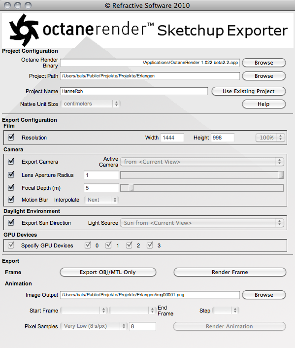

Seems it works now.
All browsers are there, export works.....
I'm not sure about the default settings radiance mentioned. But see attached

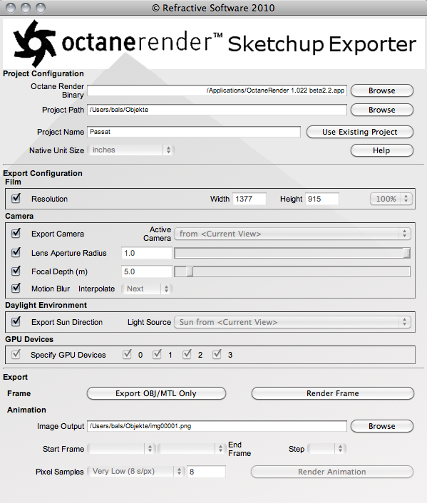

The exporter browser is blank till I click the last OK button.
After that you'll see, all is checked.
I took a fresh, never used file.
MacPro Quad * 8Gig RAM * GTX 285 Mac Edition ( delete two GT120 to make it run with octane! ) * Snow Leopard 10.6

The file does not change everything.
For changing the values:
All works except resolution changes and ( if there are possibilities ) Active Camera and Light Sources
But maybe that's not actvated yet?
