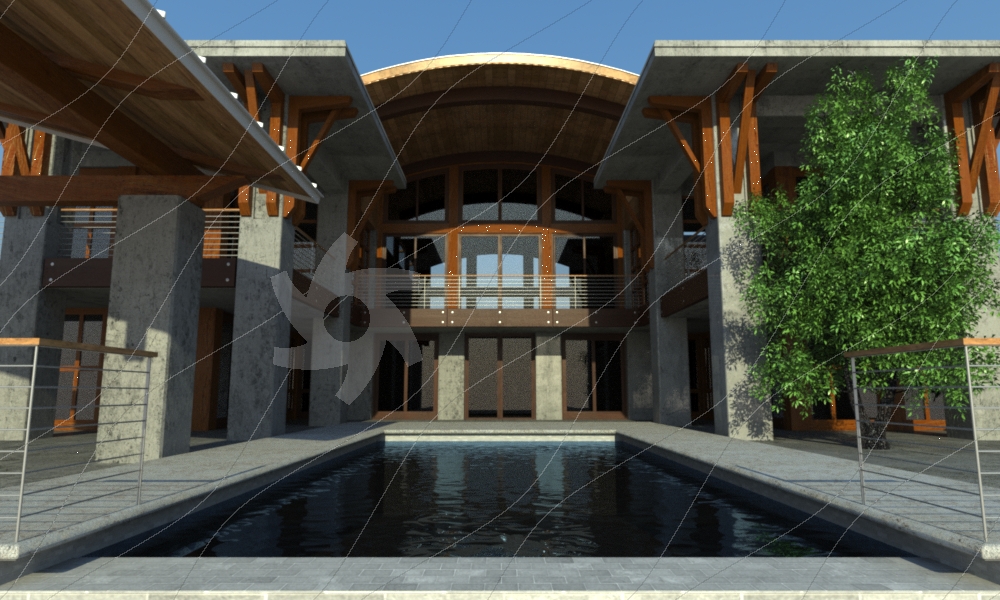

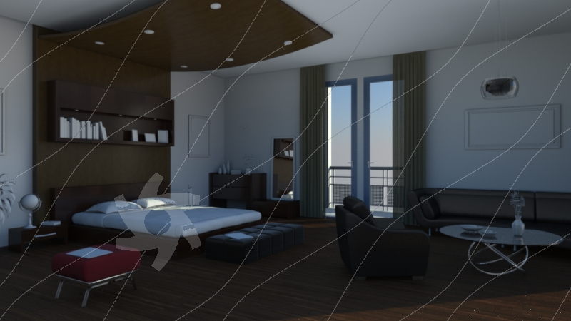

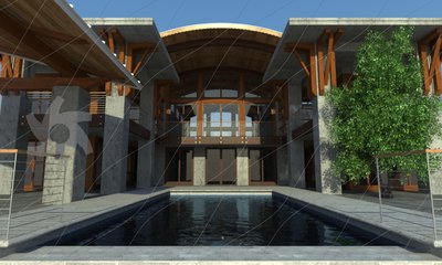

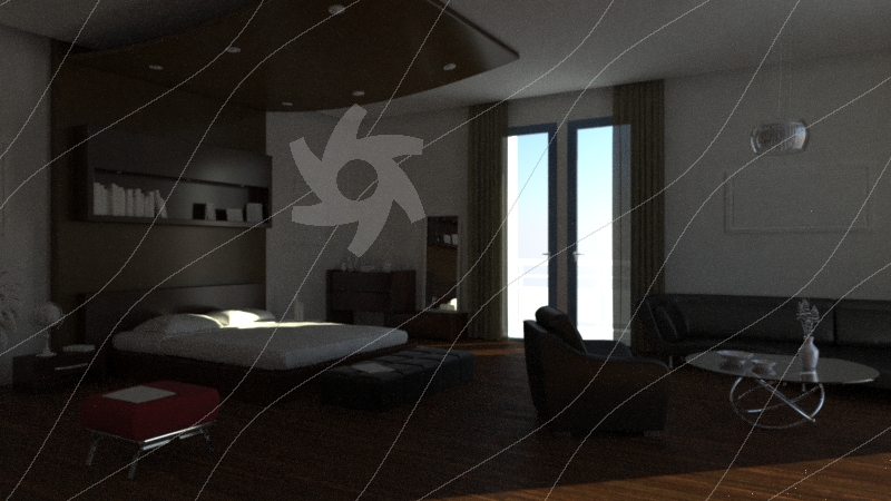

-The white dots: As we began testing octane on Maya we've notice weird white dots being scattered around the image randomly, we tried to go through the different settings that are available but none could get rid of them(I've attached several images that point out this major problem).
-On the attached images(the bedroom) it can be noticed that behind the glob of glass it's black when using Direct light(AO) and it's white when using PMC, tho we know that The Direct AO is more for preview but it is a decent image and it can be used.

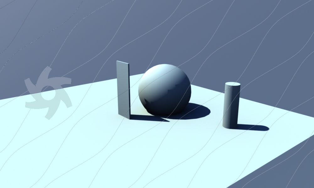

-There is another issue with the shadow that's being cast on object or from objects, it isn't smooth, we know that we can add more divisions to the object to make it smooth and solving this problem but it will make the model heavier. We noticed that the smooth display in maya referring to "3" on the keyboard is not supported(Attached image shows hard edges on the sphere and on the floor).

JPF wrote:-The white dots: As we began testing octane on Maya we've notice weird white dots being scattered around the image randomly, we tried to go through the different settings that are available but none could get rid of them(I've attached several images that point out this major problem).
Did you try the hotpixel removal tool in the Octane imager settings (in the camera settings)? A value of 0 is full strength, 1 is disabled.

JPF wrote:-There is another issue with the shadow that's being cast on object or from objects, it isn't smooth, we know that we can add more divisions to the object to make it smooth and solving this problem but it will make the model heavier. We noticed that the smooth display in maya referring to "3" on the keyboard is not supported(Attached image shows hard edges on the sphere and on the floor).
The smooth function does it's best but nothing beats upping the geometry. Usually this is not a problem in terms of VRAM unless you have a really high poly scene. Textures and render target (if your doing a high-res render) are usually the main memory users.
