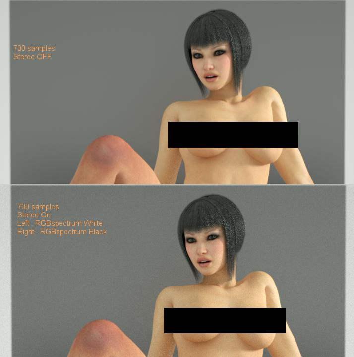

A picture for comparison 700 samples no-stereo/ 700 sample stereo left white right black
http://www.savoie.info/Stereocomparaison.png

sorry, i update the post subject nowoops, nudity warning ?
Sorry I'm at work....
(i croped the picture : )))) )
For the problem :
well, i think i know why ...
it's because even if im rendering only left on the scree, the plugin is still rendering right eye, so 2xrendering , so when i want 700 sample, i only get 350 for each eye...
so my super wish for next plugin update :
solution 1 beta:
-when one eye is black/white, only one is effectively rendered
or
solution 2 finale :
-when one eye is black/white, the 2 eyes are rendered at the full Sample value and saved in renamed separate files.
Possible ?
