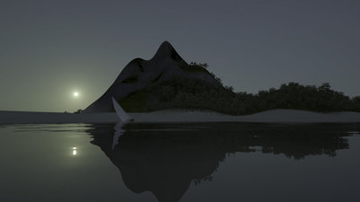

+1
However I suggest trying to change the White Balance to a Heavy Yellow Color and you might get some night-looking shots like this one I made last week:
GTX 1080Ti 11GB (3x), Water-cooled

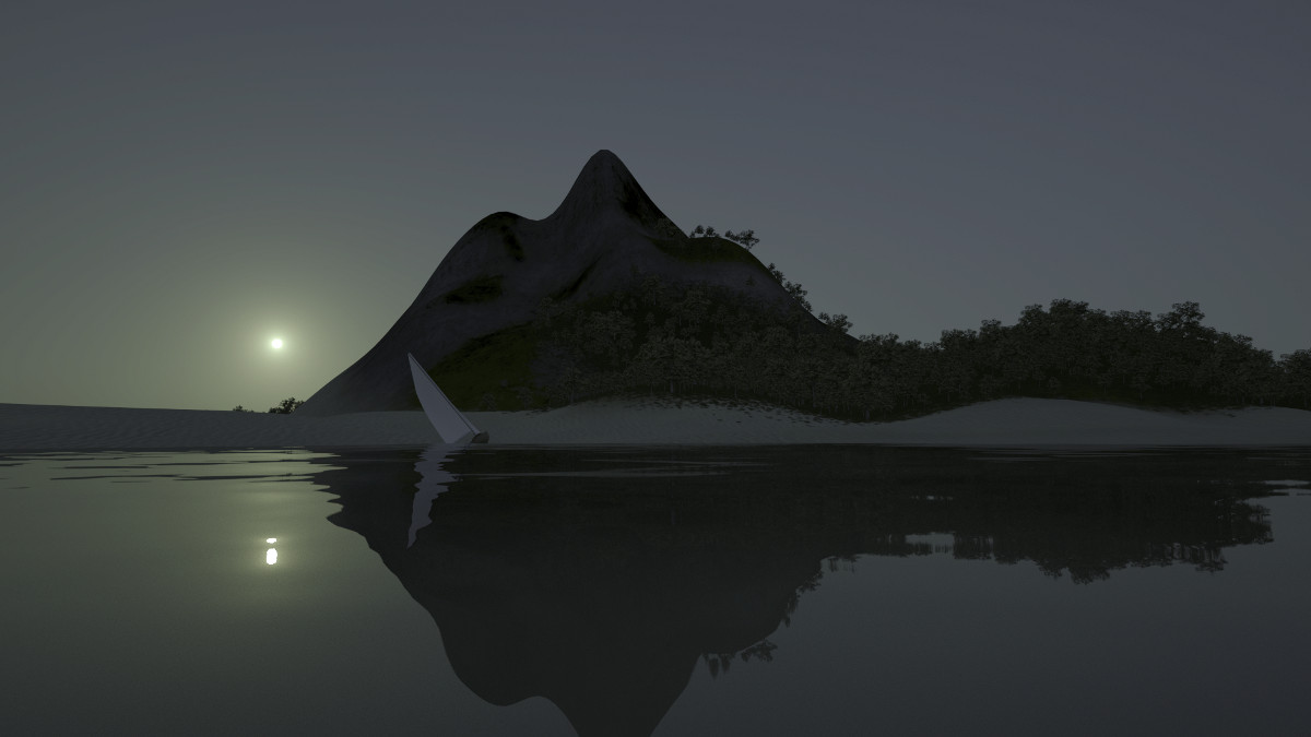

Another thing to try is decreasing the power of the daylight, increase the turbidity, then play with the imagers gamma, saturation and exposure to get a more washed out image. Looking straight at the "sun" still won't look right but you might be able to get an ok atmosphere from tweaking these.
Quick test:
Chris.
